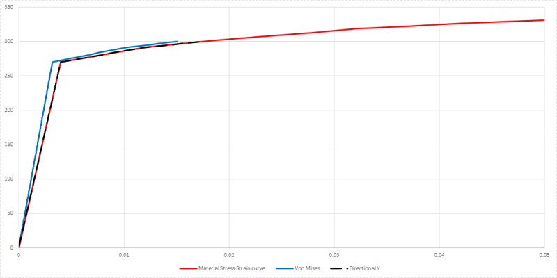

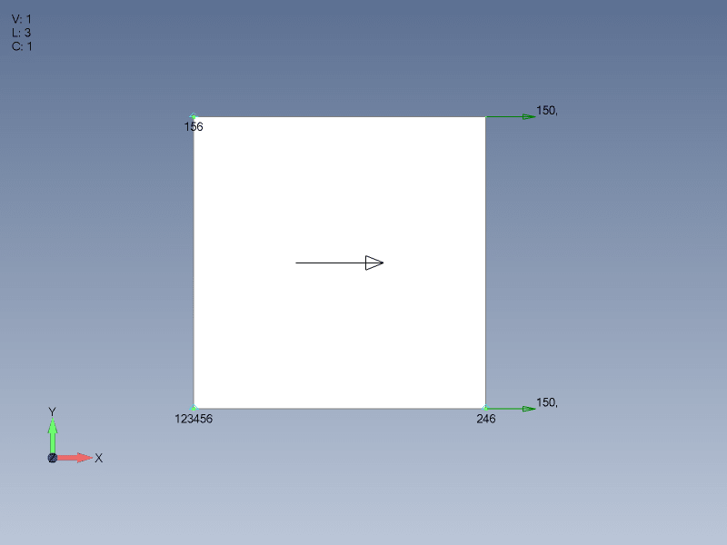

rb1957, you are correct. I have modified ecFem model and made simple one element test model with uniaxial loading and defined material direction. Directional element stress vs strain results precisely fit material s-s curve and von Mises results don`t.

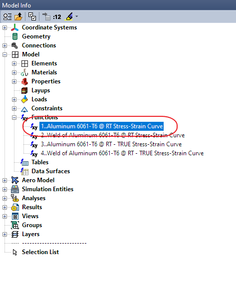

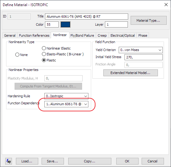

where is the NL material defined ? I expected to see a set of points, all i see is "plastic" option ??
yeah, saw that. how do you see what it says there ?
Do not understand you. That field contains link to function with Stress-Strain curve. Is it some trick i don't know?
ok, where is this function defined ?
the things you learn here !!

I am not Topic Starter and don`t have problems with pressure vessel. I made test model and get some results. You can find spreadsheet with those results and test model in .dat format in archive attached to post #5. You can open it by yourself or ask ecFem to open it for you.

yes, I saw that. I meant that I've never used this function in FeMap before ... and so I learnt something.
I think we've answered the question ... von Mises stress doesn't follow Young's modulus.
OP could test this using a quad model and changing the applied load (changing the ratio of shear stress to tension).
If the internal loads are pure axial, then vM is the same as stress_x and would follow Young's modulus.
But in more complex internal loads (axial and shear) I think vM doesn't follow Young's modulus.

1 ... I think the question is "wrong" !? Your material curve is being used, for the normal and shear stresses. The fact that when these stresses are combined into something else (either principal or vM) then their slope is "slightly" different is a result of the calculation, not an "error". Material curves are typically from compact tension test specimens (like stress_x). What you're seeing (as an error) is correct, IMHO.
2 ... pass
3 ... sure, could be a weld. I drilled into the model only so far (until I could pick an element, just to see)
4 ... see answer above in 1. That's why I suggested running test models to see that different shear to normal stress ratios give different vM results (and different slopes). I could work the math, but don't care to.
