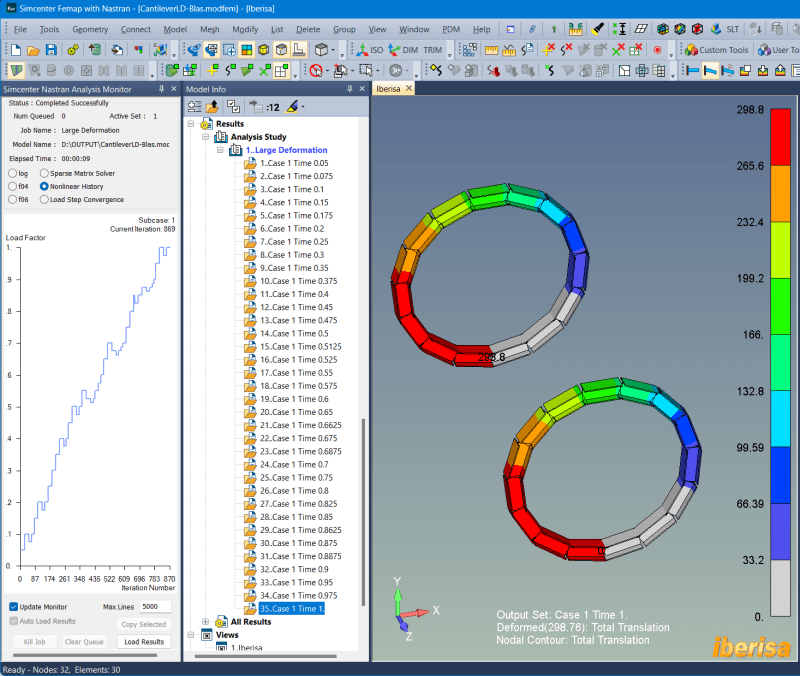

I am using FEMAP version 2306. I performed the "Large Deformation - Cantilever Beam" example provided by Simcenter FEMAP. I cannot get the same the full non-linear analysis results as given in the example document. (I can only get the linear result). I went to the example fold and copy the original FEMAP model file "CantileverLD.modfem"to my local fold and run the analysis and it worked successfully.
However, when I export a NASTRAN file form this working model to generate a NASTRAN input file; then read this *.nas file gain into a new blank FEMAP model; then run the analysis again, I can only get the linear results. NOT Full NONLINEAR RESULT.
I think there something happened during the export process. And this example is very sensitive to nonlinear parameters.
Does anyone know about this issue? I uploaded the working *.modfem file.

I ran your FEMAP model and the analysis runs correctly, why you say "I cannot get the same full non-lienar analysis rersults"??.
You need to play with "Actual Deformation = ON" and "Scale Deformation = 1" to see nonlinear displacements results at scale 1:1 (real scale deformed shape).
See the link of the picture:
