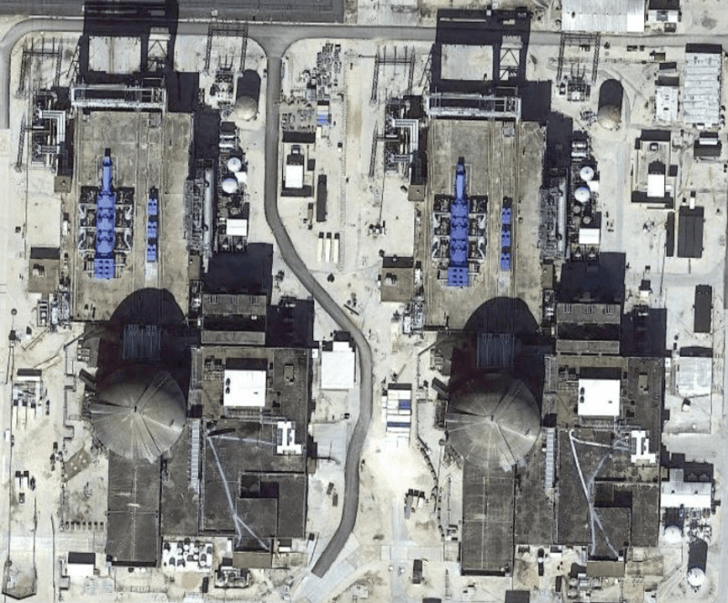

Some info on the STP trip: Link
STP spokesperson said:
On Monday, Feb. 15, 2021, at 0537, an automatic reactor trip occurred at South Texas Project in Unit 1. The trip resulted from a loss of feedwater attributed to a cold weather-related failure of a pressure sensing lines to the feedwater pumps, causing a false signal, which in turn, caused the feedwater pump to trip. This event occurred in the secondary side of the plant (non-nuclear part of the unit). The reactor trip was a result of the feedwater pump trips. The primary side of the plant (nuclear side) is safe and secured.
