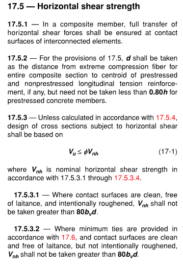

This has been nagging at me something fierce. I think that I may have something. The clip below is from ACI 318-11, the horizontal shear provisions for composite members. Based on §17.5.3, you should be able to count on a horizontal shear capacity that would garner you and equivalent, factored, vertical shear capacity of;
0.75 x 0.8-ish x 12" x 80 lb/in^2 = 576 lb/ft per inch of waffle slab depth. That's not too shabby. For an 8" system, that's 4.6 k/ft or.
Interestingly, I think that this formulation suggests that you're only getting about 48 psi of factored direct shear capacity. I'm starting to feel that our problem here is not with the shear capacity of the topping interface but, rather, with our(my) formulation of the horizontal shear demand.
If one could make the argument that one way shear is all that matters here, then 4.6-ish k/ft is probably fine. It's only when you start trying to apply it to two way shear areas where things go to hell in a hand basket. This takes me back to the comment that I made near the top:
KootK said:
2) It's always bothered me that one way shear checks exist in two way slab design as it never governs and the lateral distribution of one way shear isn't uniform at all (yes, there would be some redistribution).
I wonder if the one way shear check on two way slabs isn't really intended to check horizontal shear like we're discussing here. And that would imply that you could spread your horizontal shear over the entire design panel.
