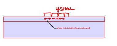

THIS IS A MULTI LEVEL TYPICAL PARKING STRUCTURE (OPEN SIDES) WITH PRECASET DOUBLE T's. I AM CONSIDERING FOR TOPPING SLAB TO USE 1 1/2" THICK LATEX MODIFIED CONCRETE WITH 6X6 W2.9XW2.9 WWR. ANY COMMENTS. LOCATION IS SOUTHERN US.

We are replacing the topping that was there, but my real question is, would you put W2.9 WWR in 1 1/2" thick LMC?

Nothing inherently wrong with adding WWR, but be clear in its purpose. If it’s intended to restrain crack width/distribution, then consider it in conjunction with your aggregate size/gradation, paste content, and water content. I would probably not spec it, though, as it’s another locus of near-surface corrosion and spalling. Parking garage maintenance is already difficult.
I vote no on the WWR:
1) Firstly, it's another corrosion vector as others have mentioned.
2) Secondly, I don't believe that WWR will even be effective for crack control here. A thin topping, bonded continuously to a substrate, will have these characteristics:
a) Good crack distribution by virtue of the shear slip restraint provided by the substrate bond and;
b) Shrinkage cracks that are not much bigger at the top than they are at the bottom because of how thin the topping is.
3) The WWR might be handy for diaphragm action but that's another kettle of fish.
Note that my intent was to sketch a "good" condition below, even if it looks like the reverse.
