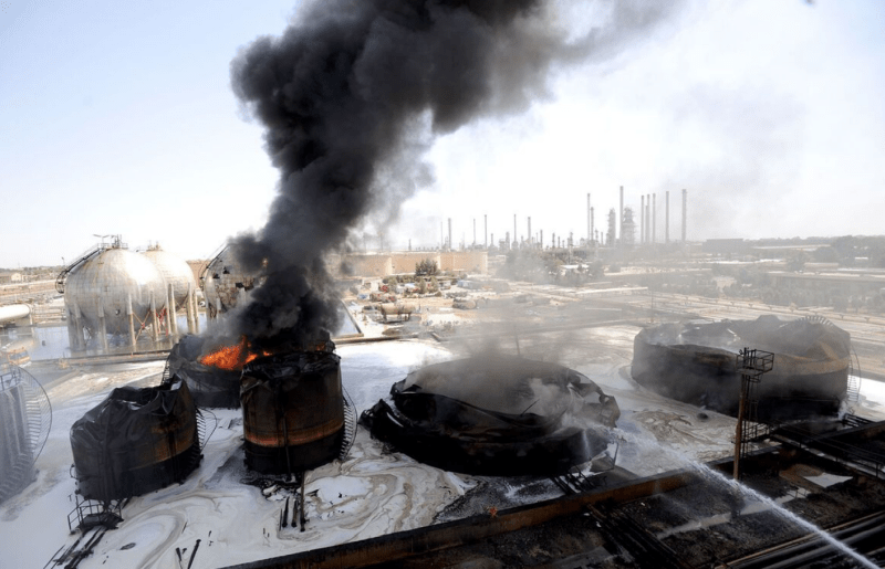

Confused messages coming from Tehran, but lots of mentions of an LPG leak/ due before the main fire. No mention though that a tank failed.
It may have been a large slops tank so maybe that was water coming out then when it failed the oil above the water layer got exposed.
The tank may have been exposed to a jet fire? Hence weakened and started leaking.

Sounds like someone who's never seen the inside of an oil refinery....
The refinery has been there 55 years - it's very likely the city has grown to encompass the refinery, not the other way around.
By looking at this picture, it seems that they didn't consider a dyke for the tanks and I recon the tanks was used primarily for water storage (and perhaps this is the reason we don't see a fire protection acting automatically for them).

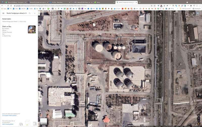

Google Map view of the tanks

But, the photo does show a wall around these tanks, which is why the fire retardant is all contained in the vicinity?
Is the height enough?

I work in a hydrocarbon storage company. Due to the characteristics of the tank (floating roof tank) it must store gasoline or something similar with a low flash point.
The collapse of the shell is spectacular and the weld must be very weak for it to open like this. That tank is not a water or LPG tank.
It looks like the product is coming out of the envelope before the collapse and the explosion. Product leakage generates an explosive atmosphere.
After detecting the initial leak, they had to trigger the fire system to fill the area with foam. In addition to removing the electrical power from the area.

The bunds are typically sized for the largest tank and to contain its volume +10%. The safest way is for each tank to have its own bund, but that takes up a LOT of space so usually you find multiple tanks within a single bund so long as it is all the same product. Especially for tanks built in 1960's.
No bund wall I am aware of considers tank failure like we saw where you get a tidal wave of liquid.
From the garbled information we have I think this tank was possibly being used as a giant water separator, hence the flammable bit was higher than the leak area and maybe having water in a tank not designed for it has caused corrosion in a seam weld. There was also mention of an earlier LPG fire which may have stressed that tank - who knows?? Also the tank may have been repurposed over time as the reports mention this being a "slops" tank.
