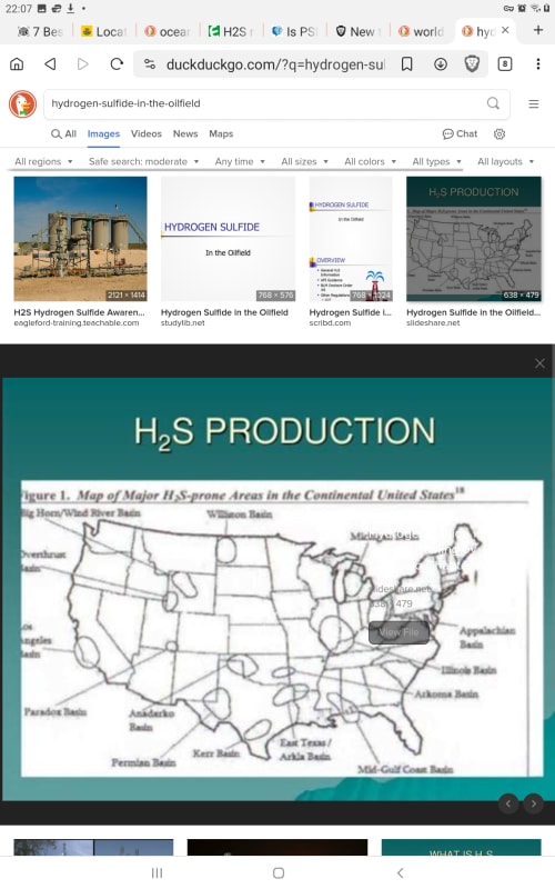

Lots of heavy metals at geothermal plants too. There used to be a huge yellow mountain range of S south of Houston. Don't know if it's still there. Could be a yellow flood zone by now. If you want to tour TX Wells with H2S content, here's the lists.
