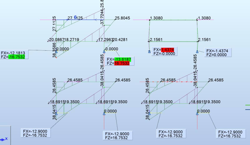

Celt83, I got a problem.
Consider the question as given, and its mirror image. Now add the two together.
We hav e net compression of 25.8 in the top member, and no forces anywhere else.
yet if we add the reactions for each pinjoint, at the left we have -12.46--13.33=0.7 kN
same at the other side -0.7 kN
Is this due to axial compression of the top member springing the posts apart at the bottom?
Cheers
Greg Locock
Incidentally this answers my own previous question to BAretired, in the absence of compressive effects the reaction at each pin will be the same size.
The reason is that in the absence of compression, we are agnostic about where the force is applied to the top member, so split it into two and apply half at each end of the top member. Now cut the structure down the middle and we have two essentially identical structures taking into account various sign changes, hence the reaction force must be equal.
Cheers
Greg Locock

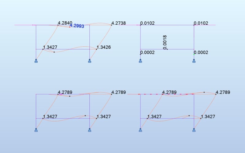

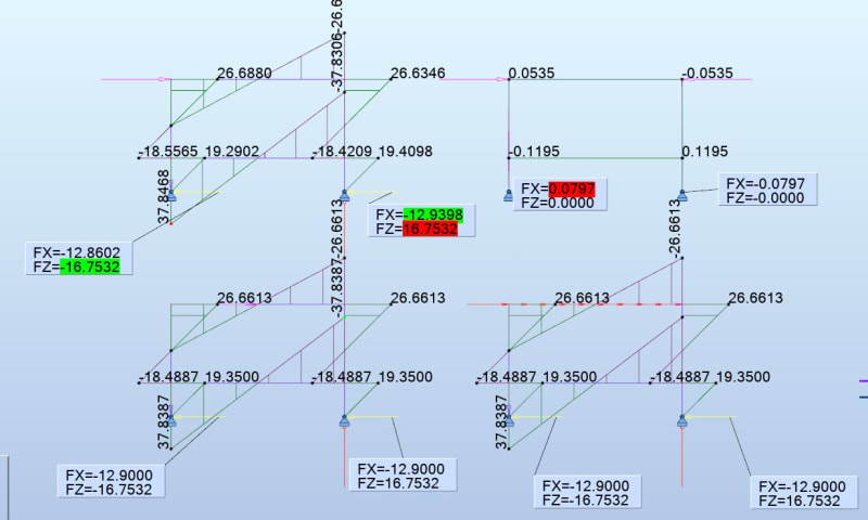

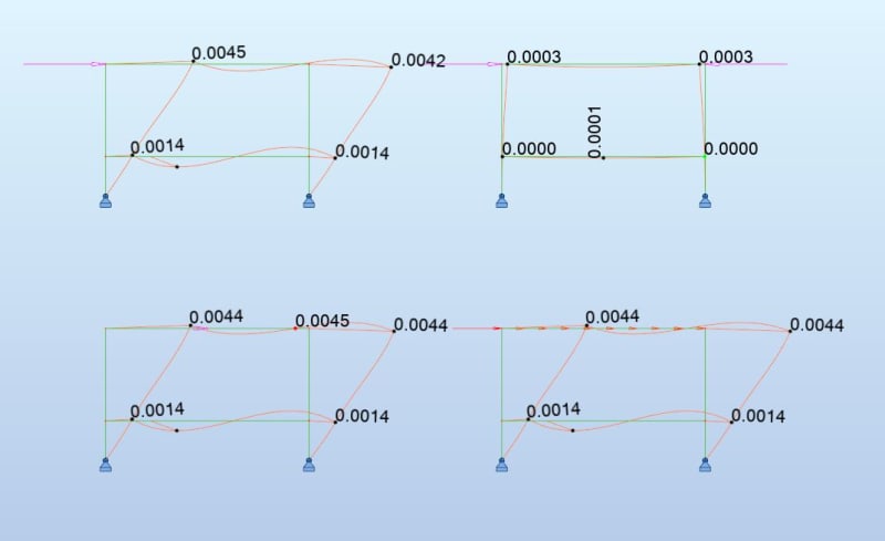

Interestingly enough it seems this structure is sensitive to the axial rigidity of the members when the load is applied to the corner nodes only.
Models:
[pre]25.8kN applied to upper left node 25.8kN applied as opposing forces to upper corner nodes
25.8kN applied to upper beam mid span 25.8kN/7.7m applied as a uniform axial load to the upper beam[/pre]
@infinite/nearly infinite axial rigidity (W44x335):
@Soft axial rigidity (W8x10):
hummm, maybe people who harp on about "validate your model" are onto something ?

So with the top left one, if we add that to its mirror image we should get the top right one.
So for the LH pin joint we'd get -12.2-(-13.6)=+1.4, and for the right -13.6-(-12.2)=-1.4
and top right agrees.
