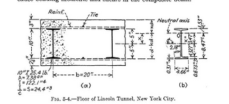

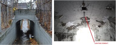

I am working on load rating of an existing bridge structure; a reinforced concrete arch built in 1902.
The structure has a short 7ft clear span with concrete profile, with 16” thick arch ring which encases 10” deep rolled steel beams spaced at 2ft on center spacing.
See attached sections of the bridge and representative photos.
(A). Based on the arch profile (with nominal surface reinforcement) it appears that the structure should behave like an arch and should be analyzed as an arch.
(B) However, the presence of the embedded steel beam makes me believe the original intent might be to treat it like a flexural member, so consider the steel beam as the main load carrying element and analyze as beam with fixed ends. Evaluate for the positive moment at mid-span which is WL2/24 for uniform load. The negative fixed end moment, WL2/12 will not govern since the depth of the structure at that location is significantly large (abutment walls).
Any thoughts on how the structure should be best analyzed, A or B? Would appreciate, if you could direct me to any references which would provide guidance on why a particular behavior is expected.
There were no significant cracks (only few minor hairline cracks) observed at the underside of the structure in the crown area.

Arch all day long for me owing to relative stiffness. If nothing else, imagine the damage that would have to be incurred in the concrete arch before the beam would kick in as any kind of simple span trabeate element.
At the least, I would start with assuming arch behavior as that's what I expect the true behavior to be. Migrate to weirder things as desperation requires.

I did a very simple sketch to show you a possible approach. Only you can say if it is appropriate for you project, or not. But it doesn't have to be very complex.
A first step can be to model the concrete arc (green) and the steel beam (blue), see figure. Use an appropriate thickness to get a reasonable stiffness and load distribution. The red lines around the beam is some type of interface, rigid/friction/free. Based on this simple start you can push the modelling further with the correct beam section, solid elements for the concrete and so on.
But the main question is, is it worth it in this particular project?
