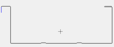

Cold Form Section Arch Buckling or Unsupported Length?
Baffled Engineer
Jul 27, 2018
62
I'm completing a review of a quonset made with cold-formed sections that gets crimped side by side as sketched below.
The arch is about 15.2m across and 6.7m high and is pinned both ends. The cold-form section will have internal compressive axial forces and bending moments.
I was wondering what would be the appropriate global buckling length (for compression) and unsupported compression flange length (for flexure) to consider?
