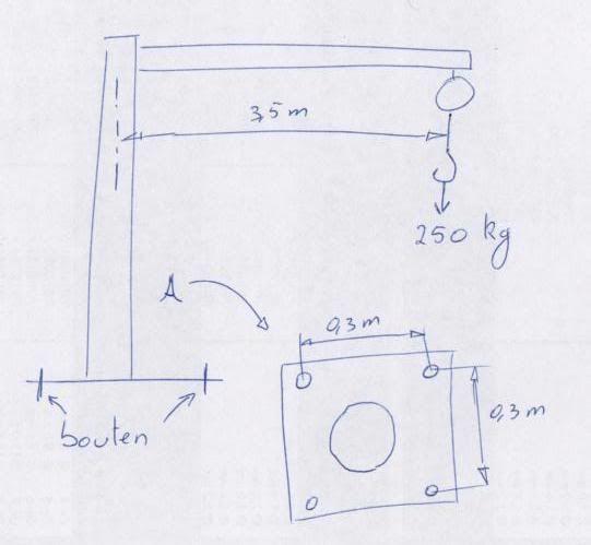

would like to fasten the frame (see attached drawing) to a concrete block.
But in my calculation, I don't need the height of the pillar. I am overlooking something. Can someone take a look at it, and tell me what I'm doing wrong?
btw, this is my responsability, this information I receive will not be used for anything that might result in personal injury.
Excuse my english, I'm european (belgium) hence the dimensions and weights are also in kg and meter.
My point of view: the weight at the hook will result in a momentum: 250 kg * 9.81 m/s² * 3.5m = 8600 Nm
Will this momentum result in a force at the two opposite bolts: F = 1/2 * 8600 / 0.3 = 14.333 N ?
Tensile area of a Metric 16 bolt = 157 mm²
stress in 1 bolt = 92 N/mm²
yield stress of such a bolt (grade 8.8) is 640 N/mm².
stress should be limited to about 1/3 of the yield stress (correct?), but still 92 N/mm² < 640/3 (213) N/mm², and I still have a safety factor of bigger than 2.
Can anyone tell me why I didn't use the height of the pillar? Where did I miss something?

The height has nothing to do with the moment (not momentum). Your calculation is basically correct, although you should include the mass of the jib boom, and don't forget the hoist. I would use a smaller lever arm for the base plate, say 200 rather than 300, as the bolt on the compression side is not the resisting element. Without the boom and hoist, this would make your bolt force 21.5 kN, well within the capacity of an M16 8.8 bolt.
If this is a slewing jib, you will also have to check the bolts when the jib rotates, but in view of the small force, that will probably work as well.
Hi kingnero
As already stated you should include the mass of the components, anyway I have uploaded a file on the way I would calculate the maximum bolt loads and my figure is slightly different than yours at 13.36kN.
Again the height in your case is not important except in terms of adding more mass to the components.

Your point of the lever arm being shorter than 300 mm is indeed correct, I did not think of that.
I will take mass of the components into account, however it will only be a minor factor as the boom is profiled metal (not an I-beam), and the hoist weighs maybe 5 kg at most.

Your latter part of your question looks okay to me except that there is no need to limit the stress to one third of the yield stress, although you do need a safety factor so your on the right side of caution using the value you have chosen. Remember also that your bolt pre-load should be greater than the external load acting on them otherwise your joint won't hold.
When you account for the mass of the components remember to calculate the centre of gravity for the combined parts as it will likely not be in between or even central between the fixing and you will have to treat it like an offset load like your first part.
Also if you consider the edge of the plate to be the pivot point for over turning it will be slightly larger than 300mm as per my uploaded file.

The permissible (working load) capacity of an M16 8.8 bolt is about 58 kN, in accordance with my old Australian safe load tables. So you have plenty of capacity no matter how you figure it. Personally, I would use M20 grade 4.6 bolts, with a permissible tensile capacity of 35 kN. Grade 4.6 bolts are more readily available as anchor bolts.

Where the compression resultant would be depends on the plate thickness, and you didn't ask us to determine that. The thicker the plate, the longer the lever arm. I was being conservative and limiting the lever arm to the distance from the tension bolts to approximately the edge of the post.

I was using the edge of the plate as the pivot because in reality thats were it will pivot from, by using the edge of the plate you can also calculate what small proportion of load is in the front pair of bolts whereas your previous method is assuming they don't carry any load which is conservative.
It is not the thickness of the plate I was referring too but the width, your sketch shows 0.3m betwen hole centres however the material from the hole centre to the edge of the plate you didn't give so I assumed 20mm between the first set of holes on the compression side and the edge of the plate as detailed in my calculation.
Another advantage of the method I give you is that it works for any number of bolt rows ie:- you have 4 bolts spaced on two rows however if you had three or four rows with any number of bolts in a row my method still works but your original method cannot as you have more unknowns.

I would always take the moment from the compression flange of the column. The flange is where the compression force is, to take the compression force to the edge of the plate means a thicker plate.

Do not forget dynamic coefficient (kd=2). When lifting 250 kg, in calculations you should use 500 kg.
Also, for lifting mechanisms, the safety factor should be more than 2, depending on country regulations. I would use 4.
It is strongly recommended to check the concrete base plate for overturning, as someone mentioned above.

The "tipping point" in reality completely depends on the thickness of the baseplate, as mentioned by others on this thread. Your example of the 150mm spaced bolts is subject to this as well. If in kingnero's case the plate was extremely thin, it would tip at the compression flange of the lift (conservatively approximated by hokie66). If the plate is extremely thick, the tipping point could indeed be at the plate edge, thereby putting all bolts in tension.

The original post I responded to gave no dimensions of baseplate thickness and the calculation the OP presented also assumed the baseplate was rigid.
The original question was the how to calculate the size of bolts, in that sense assuming the baseplate is rigid and transferring all the load onto the bolts makes the calculation conservative in the respect of bolt size.
However I appreciate that the baseplate thickness is important and since more information as come to light the thread is taking a new twist.
