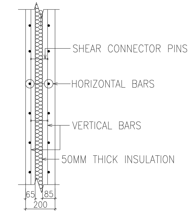

Dear All,
If I define the wall as precast sandwich insulation wall panel (max thermal transmittance, U-value of 0.57 W/m2K), what could be the value of stiffness modifier to be specified in ETABS to obtain an actual behavior??
Thank you,
