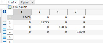

Dear all
I am trying to simply compute the natural frequencies of a 4 storey structure in ETABS. I am also trying to validate them in MATLAB. However, I am getting drastic differences in the results. This is strange because a couple of years ago I did a dynamics of structures coursework (however using SAP2000) and I didn't have a problem of them matching.
These are the results from ETABS:
The first mode has a circular frequency of 15.7129 rads/sec.
Here is MATLAB
Code:
clear, clc, close all
% Structural Properties
E = 2.1E+08;
I = 11696/100^4;
L = 5;
h = 3;
c = 0.05;
% Stiffness of a single floor
kx = 4*(12*E*I)/h^3
% Stiffness Matrix
K = [2*kx -kx 0 0;
     -kx 2*kx -kx 0;
     0 -kx 2*kx -kx;
     0 0 -kx kx]
% Mass matrix
M = [1676.5 1676.5 1676.5 1366]
M = diag(M)
% Compute mode shapes and circular frequencies
[Phi w2] = eig(K,M)
% Circular frequencies
wf = sqrt(w2)
The first frequency is 1.8468 rads/sec. This is a massive difference! Perhaps I am doing something wrong in ETABS, but there must be something dreadfully wrong.

what do the etabs mode shapes look like?
You frequencies seem to be out by 2pi roughly.
Just by eye your second matlab modeshape doesn't pass the sniff test. I skipped stiffness matrix methods at uni so I don't know if your matlab is right, but you have defined L and not used it.

Sorry that makes no sense, you can't have non zero eigenvalues with zero value eigenvectors. So it is a modelling problem. The second mode you posted bears only a cursory similarity to the matlab one.

No I haven't used ETABS and I don't have any experience with the stiffness matrix method in matlab. OTOH I have been using FEA since 1982, and measuring experimental mode shapes since 1983. your list of eigenvectors and eigenvalues from ETABS looks wrong, and mode 2 from matlab looks wrong, first floor is moving too much, top floor not enough.
