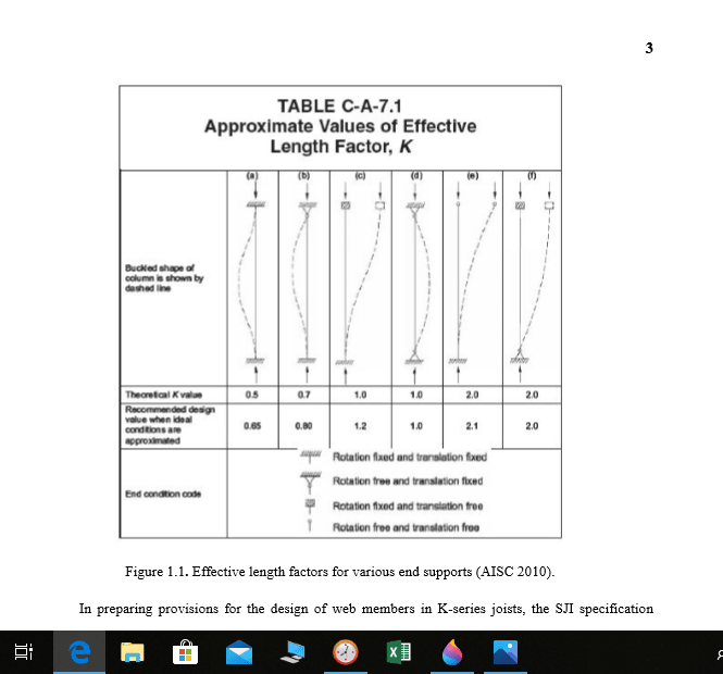

B)Often these are double storey or triple storey columns, and often have a physical void at the floor levels (e.g. a double height column would effectively be two smaller columns but produced as a single member with the main reinforcement running through the void. This section of the reinforcement is designed to prevent a combination of compression buckling and local moment at ultimate limit state - both for the pitching case, and the case when installed when it effectively takes the compression load from the upper sections of the column.
Prior to me taking over, standard practice in calculating the compression buckling capacity was to assume an effective length of 0.7 x the bar length between the concrete sections. I have since changed this to 1.5x the bar length between the end links in the concrete sections during pitching(on the basis that this section effectively behaves as in a semi-sway or sway type mode - i.e. like a truss where the central bay works on vierendeel truss principles) and between 1.5 and 2 for the case when installed (as overall column curvature is that of a cantilever). Am struggling to find any formal or written justification for this method - the only thing I can think of is using a frame effective length coefficient method similar to that found in appendix D and E of BS5950 - but setting the beam values to zero to effectively treat these bars as a compression member of two different section sizes and restraint conditions. Have used this in the past to analyse very old portal frame columns where the column is supporting a gantry crane and formed of two different UB sections. Thoughts on this welcome..... see sketch attached.

B) Agreed that a away factor greater than 1 is appropriate. Something even more than 1.2 per AISC for fixed and fixed(sway), assuming some elastic deformations lead to rotation between the two segments. But I don't have anything more definitive than that short of buckling analysis.

B) I do not feel that a sway mechanism needs to considered for the case of bar compression induced predominantly by flexure. Any sway mechanism that forms would need to sway-deform all of the bars of the cross section, including the bars in tension. And, for every bar in compression suffering from destabilizing P-delta effects, there will a corresponding bar in tension benefiting from stabilizing P-delta effects. I believe that the two effects will cancel one another out. Naturally, you'll have some degree of shear demand to deal with at the void and that will necessitate treatment of the rebar as a little beam-columns to account for the vierendeel action. That doesn't change the buckling analysis however. Whether this was the logic used by your predecessor, or they just didn't think about sway and got lucky, your guess is as good as mine (probably better).

B) You are quite conservative. See chart below.

On (B) I think I'll stick with the 1.5...but appreciate that sway factors can be lower. Part of the potential conservatism comes from a background in steel design and some of the glaring holes in the old British Standard concerning sway (i.e. it was possible to have non-sway, sway sensitive structures and conversely, non-sway sensitive sway structures...
