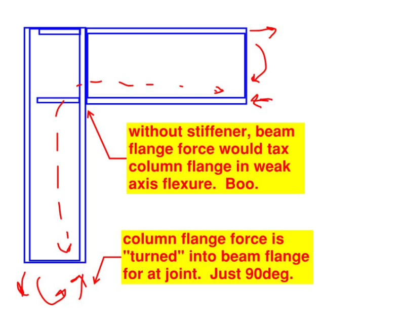

dold said:
So this gives reason to providing a plate between the beams as shown in human909's connection diagrams (b & d), no? Keeps the flanges from moving outward?
Precisely. This is one of the primary reasons for stiffeners in a lot of steel member moment connections: to change the direction of a flange force utilizing the in in plane stiffness of a stiffener rather than the out of plane flexure of the flanges. This is fundamental to robust steel detailing in the absence of concern for economy. Sometimes it's the way to go about achieving economy but not always (bolted end plate moment connections etc).

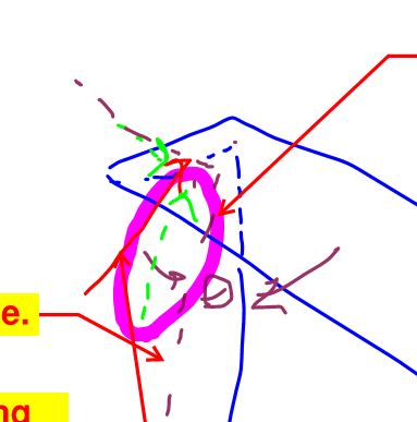

EZ said:
Was looking for some guidance on why there is weak axis bending of the flanges at the kinked joint - not able to picture it in my head...
Ahh... I see. It's the force in my previous channel sketch circled in purple below. If you imagine the channel sketch as just half of a tube, it's pretty much the same thing.
With respect to my comments in my previous post, I think that it's useful to remember that this same business of trying to avoid weak axis plate flexure in mitered HSS and channel moment connections is conceptually no different from the much more familiar case shown below. Somehow it's just a lot easier to visualize with orthogonal WF.

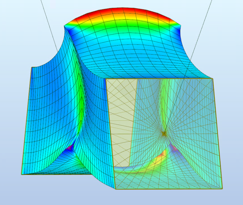

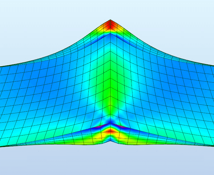

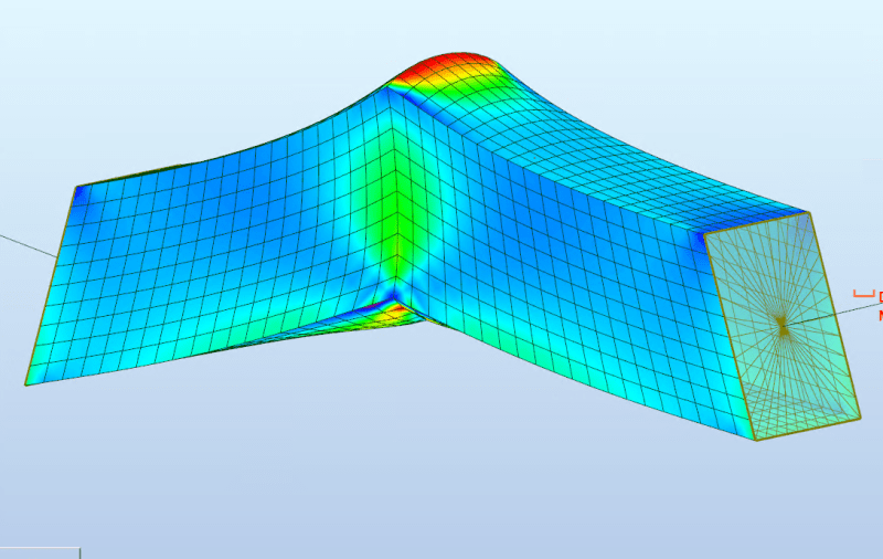

EZBuilding I had trouble visualizing it myself and for S&G's popped it into a 5 minute model this has the deformation significantly amped up but you can see the top and bottom walls bulging outward and the side walls collapsing inward:

CDLD, KootK and Celt83 - thanks to all for that input. The comparison to the stiffener plates on a beam/column moment connection was helpful, as was the FBD showing the unbalance tension/compression resultants of the moment at the peak. The FEA output was also great!

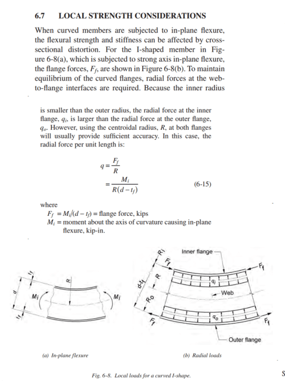

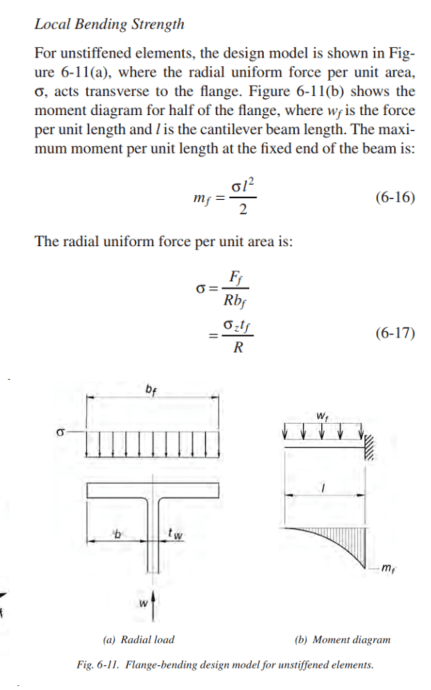

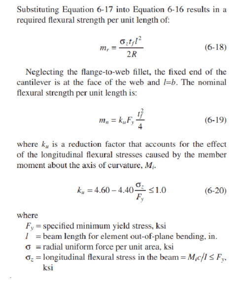

I think I may have found a suitable design method in ASIC DG 33 "Curved Member Design".
This DG is intended for vertically curved members, however I believe the provisions could be applied to the joints of cranked beams.
The DG provides methods for calculating the local flange bending (and its interaction with longitudinal stresses) as well as web stress.
I've only posted the flange bending for I-shapes; in the DG you can find guidance for tackling HSS as well as local buckling of the web.
