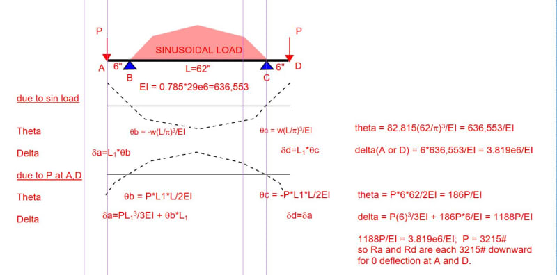

To all:
The total length of the shaft is 74". The sine load is only applied between supports B & C which are 62" apart. The total force applied to the 62" diameter round blade is F = 30 "H20 x 0.03609 lb/In^2/"H20 x PI (62"/2)^2 = 3,268.75 Lb. W = 3,268.75 lb * PI / 62" / 2 = 82.815 lb/in. For the 2 support beam deflection software example the length is 74", section B-C is 62" and sections A-B and C-D are both 6". The reactions at supports A and B are, by symmetry, 3268.75 / 2 = 1.634.375 lb.
I have thoroughly compared the SkyCiv 2 support beam report against my elastic line derivation, which has sets of equations for 0 <= x <= a and another set for a <= x <= a+D, where D is the diameter of the valve blade. And as Celt83 observed above there are 7 constants of integration in these two sets of equations, 4 of which are non-zero.
I do not have equations derived for the 4 support beam so am unable to verify the 4 support SkyCiv report. I assume it is correct. If it is, then the reactions at supports A & D = 3,214.236 (down) and those at supports B & C = 4,848.263 (up). The sum of the reactions is 3,268.05 lb (up) which matches the total force on the blade. This gives some support to the accuracy of the report.
If we could get back to my original problem... how to solve the statically indeterminate 4 support beam, I would appreciate it.
If I could focus the discussion back to the post by BAretired dated 17 Sep 24 02:54 above I would appreciate it. I the diagram the slope at support A, due to Ra is shown as 2RaL^2/3EI. Similarly, the slope due to Rd at support D is shown as 2RdL^2/3EI. I thought I understood where this came from by I am not clear on it now.
I wrote in my post dated 22 Sep 24 18:38: Add Slope at Support B to Slope at free end of Cantilever beam: Ra*a*L/3EI + P*a^2/2EI ==> P=2RaL/3a ==> Slope = 2*Ra*L*a/3EI.
Now I am looking at this again and I think the answer is:
Slope at Free End of Cantilever Beam = PL^2/2EI + Slope at support B = Ml/3EI. P = Ra and M = RaL. So slope = RaL^2/2EI + RaL^2/3EI. Adding these two terms together results in 5RaL^2/6EI. Can you explain how you get 2RaL^2/3EI?
Your posts to date have been both interesting and helpful. Please help me get to the finish line on this.

given the loading the obvious way is to reduce the beam to BC with a full span load. Solve for the slope at one end (B) (now symmetric). now you know the displacement of the overhang, at A. Now apply a unit load at the end of the overhang (A) and solve for the displacement of that end (A). Now you have the solution for the load at that end (A) and can resolve for the reaction at B.

I have now done my own analysis with the sine loading and find:
R0 = -3214.9 lbf
R1 = 4849.3 lbf
which is pretty close to the computer results provided. They also agree with results from my continuous beam spreadsheet. My solution uses the "exact" sine distribution, which would account for the small differences from the computer analysis, which I presume used a series of trapezoidal loads.
The solution method was as outlined by rb1957. My calcs are pretty untidy at the moment, so I won't post them today. I'll try and find time to tidy them up and post later.
More details of the analysis procedure:
Analyse for unit maximum load/l and unit EI.
1: Analyse half the beam supported by one internal support and moment fixity at mid-span.
2: Integrate the applied load to mid-span twice to find the applied load and mid-span moment and curvature.
3: Integrate again, assuming zero slope at the support, to find slope at mid-span.
4: Rotate for zero slope at mid span to find the slope at the support, and hence the deflection at the left hand end.
5: With a similar procedure, find the deflection at the left hand end due to unit point load, and hence the force required to fix the end of the beam (R0) and then R1 = R0 + applied load.
6: Multiply by the maximum force/l for the final support reactions.
7: If required, factor the slopes and deflections by w and divide by EI.

OK, quick summary of results with supports at the beam ends, and full load applied with specified EI values, using my beam analysis spreadsheet, with the sine load approximated with 32 trapezoidal loads:
With full sinusoidal load applied from 6 to 68":
Reaction = 1633 lb
Deflection at 6" = 0.2529"
With unit load at 6 and 68":
Deflection = 5.21854E-05
Force required for zero net deflection at internal supports = 0.2529/5.21854E-05 = 4845.4 lb
Reaction at end supports = -4845 + 1633 = -3212 lb
So all consistent with the previous analysis.

no BA, I think it is the unit load portion of solving a redundant structure.
@LFIII ... is your text book a basic undergrad book where maybe they don't consider redundant or indeterminate structures ? look to see if either of these terms are in the table of contents. If your book includes these then it will almost certainly include the Unit Force Method, which is what we're talking about. If your text is by that great theoretician Timoshenko, maybe chapter 8 "statically indeterminate problems in bending" will describe other ways to solve this problem (I didn't see Unit Load method explicitly listed in the table of contents).
What is the struggle with a sine loading ? solve it like any other loading ... method of cuts ... determine the external reactions, then ... the difficulty could be in finding the centroid of a partial sine loading ... if I had to do it from first principals I'd look at a slice of load and integrate from 0 to x.

Eliminating supports A and D, Ra and Rd are each found to be 3215# downward for zero deflection at A, B, C and D. This is in agreement with Doug's result.
BAretired:
One word: Elegant.
I had all the pieces the first time I looked at this but could not see the forest for the trees.
Thank you.
Well, actually, I had an error in the expression for theta due to Ra and Rd (missing a 2 in the denominator), so you would not have got the correct answer the first time around. We seniors have our good days and bad days.
My calculations from 1st principals gives Ra = -3214.9 lbf and Rb = 4849.9 lbf. This is the same as other posted results.
The method was based on M/EI. The boundary conditions were zero gradient at mid point of beam and zero deflection at Rb. Both resulting equations were functions of Ra and Rb. The gradient at Ra was substituted into the deflection equation. The second equation was vertical force equilibrium. It seems to work!
