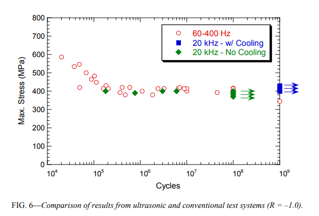

 https://files.engineering.com/getfile.aspx?folder=026359d2-8846-4db7-87d8-8d3d8628d9e9&file=Mayer-2016-Fatigue__Fracture_of_Engineering_Materials__Structures[1].pdf

Several researchers have found that conventional (low frequency) S-N tests and ultrasonic S-N tests give comparable results for Ti-6Al-4V. See the image from Morrissey ("Ultrasonic Fatigue Testing of Ti-6Al-4V", Journal of ASTM International, May 2005, Vol. 2, No. 5, Paper ID JAI12024)
Morrissey's specimens were unknotched. However, Willertz found the same results for notched Ti-6Al-4V (Kt = 2.4). (Wells, Joseph M.; Buck, Otto; Roth, Lewis D.; Tien, John K. (editors), Ultrasonic Fatigue, The Metallurgical Society of AIME, Warrendale, PA, 1982, ISBN 0–89520–397–9)

Ok, so that s/n data says 300MPa looks to be a good stress to work to. So what do you see with a typical slot ? or an ellipse ?
300MPa is 40ksi ... sounds like a very high stress, although this is Titanium. But you're looking for Aluminium ? Do you have s/n for Al specimens ?
