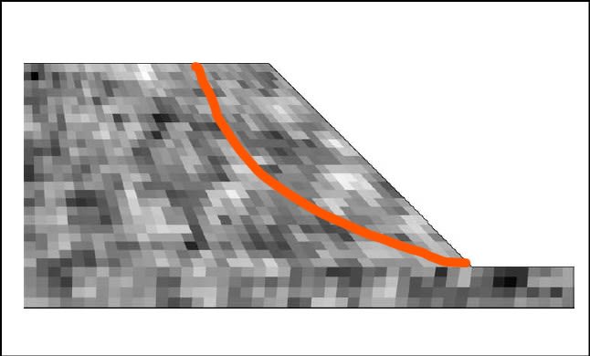

An example of a random field model in a slope is the following, from Mohammad Tabarroki; Fauziah Ahmad; Roodabeh Banaki; Sanjay K. Jha, JGGE ASCE 2013.
The first illustration is small SOF, the second illustration is large SOF, here it is well visible that elementary soil volumes tend to cluster in weaker and stronger areas.
Now, a potential slip surface will cross thru weaker and stronger fluctuations.
IF the SOF is small (figure #1), any slip surface will most probably cross thru many weaker and stronger volumes of soil, so the average strength will always govern the stability.

This is a slope in a statistically homogeneous soil with a small scale of fluctuation (SOF) of its strength (described by Su or phi, according to the soil type and rupture model used). The elementary soil volumes are small and the light ones represent smaller strength whereas the darker ones represent higher strength.
The overall strength across the potential sliding surface in red is given by the contribution of all the elementary volumes present across the surface. Since the surface is far larger than the scale of fluctuation, the overall strength is always governed by the average of the strength of the elementary volumes at the intersection with the surface itself.
If, in a probabilistic analysis, we use the variability of the population data, that is all the strength values of all the elementary volumes measured, we let single elementary volumes potentially govern the stability. But we know that the overall stability is the contribution of all volumes and the mean is its representative parameter. Hence, the variability of the strength to use as an input in the probabilistic analysis, in this specific case, must be the variability of the mean.
