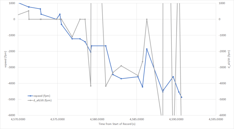

IRStuff:
"The helicopter was essentially in a dive in the last 20 seconds, going from +1000 fpm to almost -5000 fpm before signal was lost. Unclear how much noise is in the data; a casual estimate would be 300 fpm rms, which makes the one large upblip going from -4000 fpm to -2000 fpm for about 1 second, 8 seconds prior to loss of signal, very curious."
You can have -ve fpm, too. I'm speaking out of ignorance, here. Just want to know.

Dik
@dik
Not sure what you mean. The change from -4000 to -2000 fpm, if real, and not just noise, means the pilot attempted to kill the descent for about 1 second and then resumed the rapid descent.
-4000 fpm is 45 mph downward, which is insanely fast for low visibility conditions, even if the pilot thought there was clear air below him, particularly since his altitude wasn't that high, and there's risk of hitting stuff like other aircraft and trees on the way down through the muck.
TTFN (ta ta for now)
IRS: Thanks... just thought it was too fast... makes sense, now.
Dik
I down loaded the raw altitude ADS-B data.
I suspect that some of those bumps are caused by data lag. There may be a slight lag in the GPS signal. Some one second time windows have more than one data point recorded.
The big picture, that is from beginning to end of the final 10 or 12 seconds is more important than relatively small variations in the FPM.
Doing an FPM calculation based on the reported data for three consecutive seconds gives a dropping FPM of 4500FPM, 0,and 5250 fpm.
When you consider going from a drop of 45 MPH to zero in one second and then an acceleration from zero to almost 60 MPH in one second it is obvious that the data needs to be smoothed, or averages taken over a greater time frame than one second.

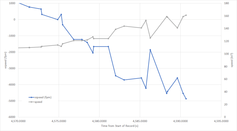

I really question the validity of those vertical velocities. If you watch the EAR WITNESS that itsmoked linked to above, he didn't indicate any rapid movements or change in engine sound. He just thought the pilot flew into the hill.
Looks like the pilot might have been changing attitude controls, since the speed curve mirrors the vertical speed, which would not drastically change engine sound, as he might have kept the throttle at the same position.
