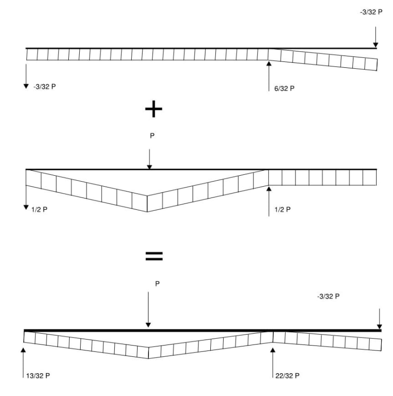

The point moment I show was an attempt to simplify the problem down to a single span beam with effects of the internal support as applied loads, which is wrong it's still just a point load, I jumped the gun on that one...whooops.
Open Source Structural Applications:
KootK said:
Is this not what we've been doing all along? I certainly have.

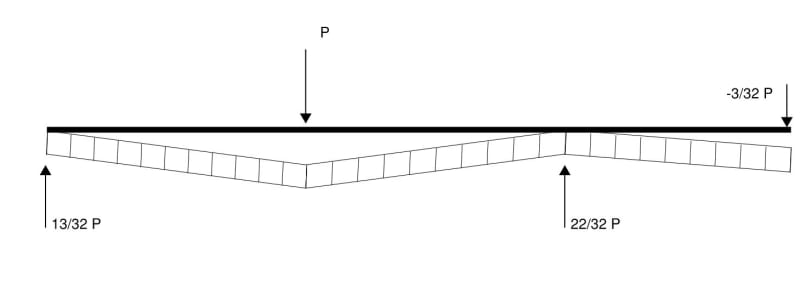

Up until your sketch, they have all been determinate systems and thus there hasn't been any reason to say if the load effects are distributed assuming flexural and / or shear distribution. Your sketch, however, is indeterminant.

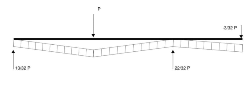

If we are to look at the shear deformation of a member who's load affects are distributed 100% by flexural deformation, our boundary conditions will be broken.
We have one degree of indeterminancy in your problem. Let's say it is the uplift (right) reaction.
If we were to assume 100% flexural deformation, and we released the right reaction, it would deflect upwards, and bringing it back to 0 deflection would require a reaction force of -3/32 P, and there would be no shear deformation.
If we were to assume 100% shear deformation, and we released the right reaction, it would not deflect at all. Bringing it back to 0 deflection would require a reaction force of 0*P = 0.
If we were to assume 50% shear 50% flexure deformation, and we released the right reaction, the deflection due to shear at the right support would not be 0, and the deflection due to flexure at the right support would not be 0, but added together they would be 0. And thus if we were to look at a diagram of shear deflection ONLY, with internal load affects distributed via flexural deformation ONLY, then the deflection at the right end would not be 0. It would look like this.

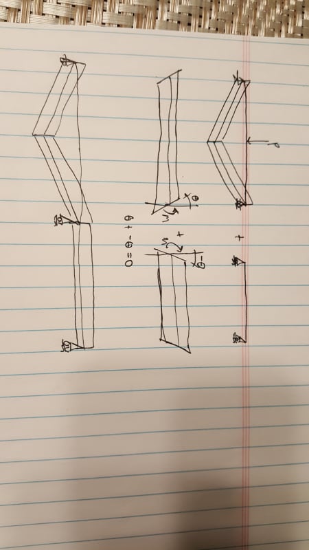

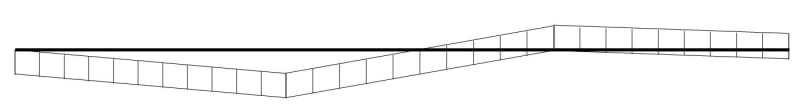

So KootK, going back to horizontal vs vertical shear strains... In the picture I posted above the transverse beam planes that were originally vertical are no longer vertical. The longitudinal plane that was originally horizontal is no longer horizontal. So, is this horizontal shear strain, or vertical shear strain? Or do you accept that it is just shear strain now? :)
To provide further light on the sketch I posted above, here's a similar picture. The difference is a rigid body rotation such that boundary conditions are not satisfied, but vertical faces remain vertical.
Even more further light. Or the the most furthest light.

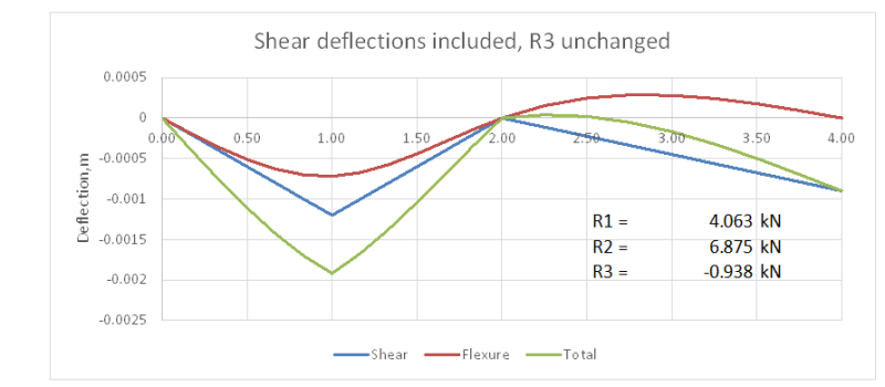

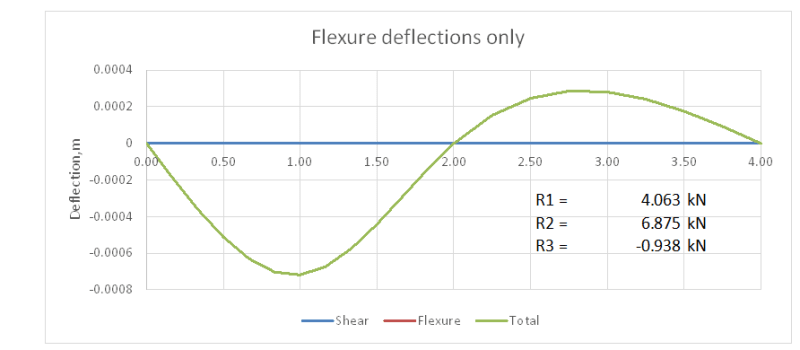

Looking at the two span beam as a single span with a point load at the right hand end, and adjusting the load to get zero deflection at the end. With an applied load of -10 kN, and ignoring shear deflections I get:
Note that the end applied force (or reaction) is exactly as shown in Kootk's original sketch.
Adding in the shear deflections, but leaving the forces unchanged we get:
Now the right hand end has deflected downwards by the shear deflection, so we need to reduce the force at the right hand end to bring the deflection back to zero:
The magnitude of the adjustment to the end force depends on the ratio of shear deflection to flexural deflection. If the section had infinite flexural stiffness and finite shear stiffness the deflection at the right hand end due to the mid-span load would be zero, so the right hand end load/reaction would also be zero.
I doubt there is a simple formula for the reactions including shear deflection, but it is easy to calculate using standard continuous beam methods, or use the Excel Goal Seek function (which is what I did to generate the graphs).

I don't think it is exactly the right answer. He seems to be using the reactions allowing for flexural deflection only.
Adjusting the reactions doesn't make a huge difference to the left mid-span deflection (at least in the example I looked at), but it does slightly increase.

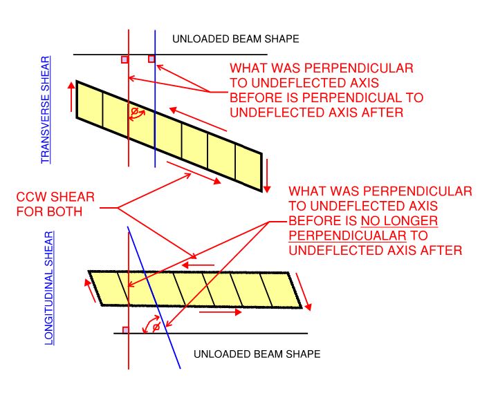

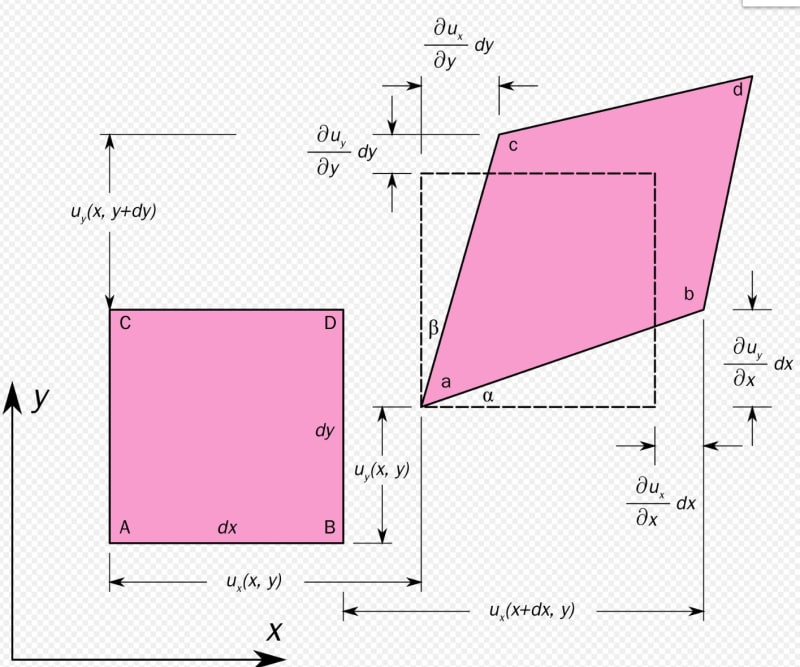

Let's remember that strain has nothing to do with rigid body rotation. It has nothing to do with global translation. It has everything to do with a member's element's deformation relative to adjacent elements, not relative to some arbitrary outside object (such as a vertical plane, horizontal plane, or your left big toe). Thus we cannot determine anything about a member's strain by it's displacement at all.
How many different types of strains are there, ever?
Two. Normal, and shear.
However, if you want to differentiate strain relative to the orthogonal, geometric axes of a member, than we can, but not in the way you have been proposing.
Let's define P,i as normal strain, parallel to the axis 'i'.
Let's define V,i as shear strain in the plane that is perpendicular to axis 'i'.
1 - Axial tension/compression (+/- P,x)
2: transverse tension/compression parallel to weak axis (+/- P,y)
3: transverse tension/compression parallel to strong axis (+/- P,z)
4: Positive and negative "beam" shear (+/- V,y)
5: A square cross section becoming a parallelogram (+/- V,x)
6. Weak axis bending beam shear (+/- V,z)
Now, consider a flexural member. On a global level, it's not really shear or axial. For strain, we do not call it "positive bending" strain, or "negative bending" strain, or even "bending strain". If it deflects upwards vs downwards that alone doesn't tell us about the strain. On the elemental level, flexural strain is the same as axial strain. It's either compressive, or tensile. Those are easy to distinguish and define. Compressive strain - elements are closer together / are compressed into smaller shapes. Doesn't matter if it's deflected up or down, left or right. Apply the inverse to tensile strain.
Now let's look at shear.
For argument's sake, lets say this is the usual case where you're right and I'm wrong. If I understand you correctly, you're proposing that there's two different types of beam strain, V,y. There's a horizontal shear strain and a vertical shear strain, both of which are in the plane normal to the axis 'y', but have some distinction from each other at the elemental level. What would "horizontal" strain look like? What would "vertical" strain look like? There must be some difference at the elemental level. We should be able to look at a differential piece and say, yup that's horizontal strain. Or, no that's actually vertical strain. I submit this is what it would look like. (FYI, this is the picture I was thinking of when I said I would respond later to you)
However, this is not how shear strain behaves. The elements don't slide past each other in only either the transverse or longitudinal direction, picking whichever one will satisfy the boundary conditions. On the elemental scale, shear strain is all the same. It is the change in angle between planes that were originally orthogonal.
Celt83 posted this first, from wikipedia.
For a beam with horizontal shear deflection, as the point moment example, or a beam with traditional, vertical shear deflection, the strain is the same. It is just a rigid body rotation that is the difference between horizontal and vertical shear deflection. It also just happens that most of our beam examples have exclusively vertical shear deflection. A good amount have horizontal shear deflection, but we don't typically look at the shear deformation of those, and so when we see the horizontal shear deformation in isolation it is unintuitive to us and we think there might be something different going on at the elemental level. But it's not, it's still the same at the elemental level.
So, pardner. Gimme your best shot.
Is this vertical shear strain, or horizontal shear strain, and what the heck is the difference between the two.

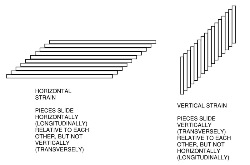

I suspect this is the source of our confusion between one another. We're going in different directions. I've no doubt muddled the verbiage in spots but I never wanted to go from a member's displacement to it's state of strain. I wanted to go from it's state of strain to it's displacement and, more precisely for my purposes, that displacement's implications for energy minimization.
This is the one thing that I disagree with. I can indeed differentiate strain relative to the member axes. And do so in exactly the way that I proposed. Differentiation is just a matter of definition and I did that via a pretty sketch earlier on. So I deny you the right to deny me the right to differentiate things as I see fit. I think that the real question is whether or my differentiation scheme is meanginful. And that's probably the gist of what you were getting at.
So, is it meaningful? Originally, I wanted a classification system by which I could say:
- This kind of strain (transverse) will yield the transverse shear deformations that we're familiar with.
- That kind of strain (longitudinal) will not yield the transverse shear deformations that we're familiar with but, rather, a strange new kind of lateral shimmy that shocks, amazes, and sometimes is not accounted for energetically in our transverse displacement math.
While we were considering simple spans, the classification was meaningful in my opinion. Once we got deeper into the weeds with cantilevers and multiple spans, however, the classification lost it's utility. I think that it still may be valid to say that longitudinal shear within one span will not do work on a transverse load within that span. But that statement involves so many qualifiers that even I don't find it useful any longer.
It's both in superposition as you nicely illustrated previously. And the difference between the two is just as it's been all along: a matter of delineation of the aggregate effect relative to the member axis. It's a difference of little consequence for this example though, I certainly agree.
Okay here's my last shot... We can certainly differentiate between the two cases, but there are not different strains going on. They are both shear strains in the XZ plane, V,y. At the elemental level there is no difference, the strains are identical. You cannot differentiate between two things that are identical. I deny you the right :)
What is not identical is their rigid body rotations, and their translations from original undeflected shapes. Like you suggest, it is indeed useful to differentiate between the two. But we cannot call it strain. It is deflection. Horizontal deflection, and vertical deflection. And just shear strain.
