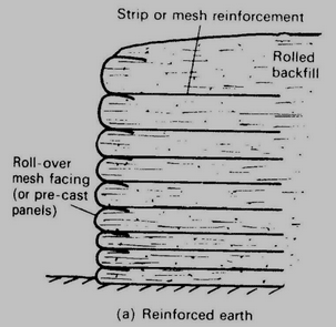

It is fascinating to watch the construction process. They appear to be using a weldable mesh material, about 10' by 15' or 20' in size to anchor the entire structure together. First a layer of this mesh was laid down, with the end two feet or so bent upwards vertical, but the rest lying flat. The vertical ends were welded to vertical rods to keep the ends vertical. Then the fill was added, leveled, and tamped, with the weight of the fill anchoring the mesh sheets, including the "ends" (or sides if you will). Once the first layer (approx two feet) was completed, another layer of mesh was laid down, again with the end two feet or so bent vertical, more vertical rods were welded in place, and the process repeated. They are progressing about one two-foot layer every two hours (so about 12 feet so far in about 12 hours). With what appears to be about 16 more feet to go, they should be ready to begin applying the final top layer sometime Sunday evening or so. It is just amazing to watch this process, because it is the weight of all of the fill that will (hopefully) keep the fill in place. Fascinating.

Typical reinforced earth process. Highway construction crews do it all the time, both for temporary and permanent works. With permanent works, the facing is concrete panels.

The cross section described i similar to this detail. Continuing the mesh across the entire fill area will minimize the work needed to retain the soil as reconstruction progresses.

...mechanically stabilized earth...aka Reinforced Earth...thanks to the French civil engineer, Henri Vidal for his modern-day version from 1960's.
