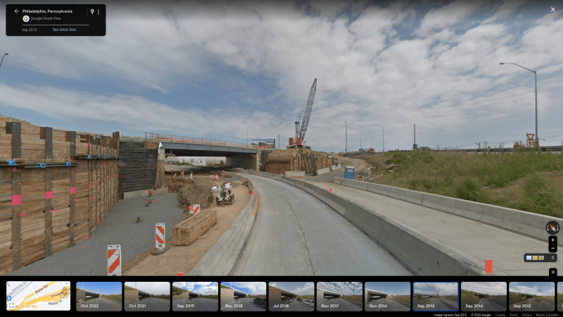

Maybe so, but when a specific bridge has this on the off ramp ( about 100m from the underpass)then it suddenly ramps up the probability of a crash by a facto of 10 or 100 or maybe 1000 compared to any other bridge.
No one is going to do 25mph coming off a freeway when they can't see the road in front of them bending left.
The structure was new in 2016. Perhaps an overshoot runout is practical in these situations.
Google Maps
The structure might be 2016, but the underpass was there in 1992.
They missed an opportunity there but maybe that's what happens with widening schemes as opposed to new ones
The underpass nearly doubled in length and is now about 50-60m long.

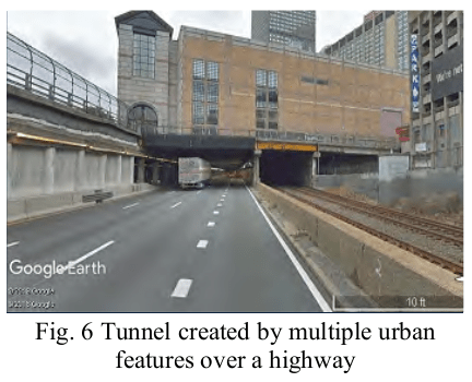

Attached is a FWHA memorandum said:
Several questions have centered on the definition of a tunnel and which types of structures are
subject to the NTIS. This memo provides further guidance on different structure types that are or
are not subject to the NTIS and can be used to guide efforts to inventory all highway tunnels by
December 11, 2015 as required by the regulation.
It's a bit long winded, but supports the idea that a bridge can become tunnel like for the purposes of the inspection program.
