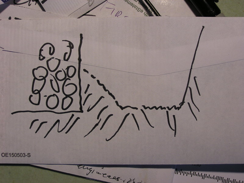

Gentlemen, final dilemma hopefully. The floor of the crawl is anywhere from 28 inches to 45 inches below grade. We dug down at lowest level and found that the stone wall foundation actually has no true footer per say and the bottom of wall is around 48 inches below grade.
I think I'm going to pour a slab after I level it but now I'm concerned with an old stone wall and no footer how close I can get to the bottom of the wall with the french drain without running the risk of drawing water from under it and causing erosion under the wall.
Another subject here. I've run into very few erosion problems as related to water flow from under footings and slabs. Usually that is when there is significant water flow and the stuff that moves is fine sand. First off is that stone foundation just a bunch of loose stones, no mortar to amount to? That is not good, but not terrible. If so, I'd keep my excavation away some, leaving say a triangular shaped zone against the lower zone.
And here is a case where you don't want to erode any of that zone. So, in no way use an open graded stone against that without a filter. Of course using concrete sand you do have that as a filter.
Otherwise ,another main problem I have seen is vibrations in the are causing the sand, usually damp, to actually flow out from under. That can be running a vibrating roller nearby or a large industrial compressor operating about 40 feet away.
Another one. Around the old prison at Waupun, WI there is a high stone wall made many years ago. It is about 3 feet wide and down about 4 feet for "foundation. Quite obviously it was built by prisoners. It is well cemented together above grade, but not so below grade. Through the years the wall has tilted a little this way and that. A grouting firm was hired to straighten it by pumping grout into zones below it as "jacks". However first any voids in the "foundation" need filling to keep it intact. I was able to take a folding ruler and insert it easily far into the voids in that "foundation". The explanation is, the guards apparently didn't watch closely because that loose foundation would be no sweat to dig through by hand to escape some day. However, the weights imposed on that supporting soil were darn high from that stone wall, yet these spaced stones carried it pretty well. So maybe the subject house is in pretty good shape even if not the most solid foundation.

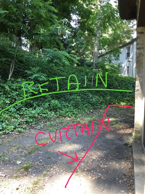

Going to try to attach a few mark ups I've done. Wondering now if the French
, or curtain drain proposed will be overkill
My picture is only showing up as a link, not sure what I've done wrong
Picture is fine. which way is the camera pointing and what do those words mean? Perhaps a sketch of what is proposed will help. You can also insert a picture as a JPG file using the icon above with a circle at the lower right corner of the screen , about in the center of the Post Options icons above. Picture won't show as you insert it, but thereafter will show along with the text.
