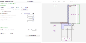

I am evaluating an exterior retaining wall that a contractor built to prescriptive codes. They came back after inspection and added two feet of additional retaining height which means insufficient rebar in the wall and inadequate footing sizes. The wall is starting to bow in the middle. The owner would like to not demo and rebuild the wall. My thoughts on repair would be to add a haunched wall butted against the existing wall with dowels and to add additional concrete/rebar to the footing. Is this the approach you all recommend? They would also be open to a buttress wall in the middle on the exposed side since that side is downhill and not visible. I don’t like this option as much.

Here is an elevation view and a section view. the sketches aren't complete but show applicable info. The contractor is pretty adamant about not wanting to excavate on the heel side. I like this solution the least, but they want to price it.
Right now i am using code minimum soil values in arizona, we will have a geotech if this repair rec is picked. The CMU is solid grouted, so should i spec the horizontal bars to extend 6" beyond the buttress so that they can dowel and epoxy into the face of the cmu wall?
More context is this was was constructed to a 6' prescriptive design, but final construction has this wall at 8' of backfill so it is stressed and bowing 1-2". The buttress is to help alleviate the stress by providing intermediate support for the wall.
Another approach the contractor is open to is abandoning the existing wall and building a new 12" CMU wall on the outside face. This would require the footing getting beefed up to the appropriate width, and also a key to help with the sliding. Straight vertical bars doesnt seem like enough bar development into the footing, but is this a feasible approach?

The new wall built butted up against the front face of the existing wall, and increasing the footing width with a key seems like the best approach to avoid any excavation on the backside. However, the concern of how to attach the new wall to the existing is still present. It's a 12" thick footing. would something like #5's at 8" o.c. doweled and epoxied into existing footing with 8" min. embed be adequate?

XR250, I am not following your response regarding coring 8" diameter holes at 5' o.c. I was talking about #5 vertical rebar being doweled into the existing footing at 8" on center. and the bars would be doweled 8" downward into the existing footing. i am wanting to connect a new CMU wall to the existing footing. The graphic above gives a visual of what i was referring to.

ah, thanks for the clarification. on that design repair rec i modified it since posting. i added back-to-back vertical c-channels at 4' on center so they align with the tiebacks being spaced at 8' o.c. plus one between each tieback, as well as back-to-back horizontal c-channels running from tieback to tieback. all of those channels should help pull the load from the wall into the channels and direct them into the tiebacks. i agree this approach is costly, and not my number 1 recommended choice. i recommended remove and replace, but they are looking for all potential options to price compare.
my last option i plan to offer is the new wall constructed in front of the old wall, but like i mentioned not sure about the vertical bars doweling into the existing footing if that would be adequate enough.
