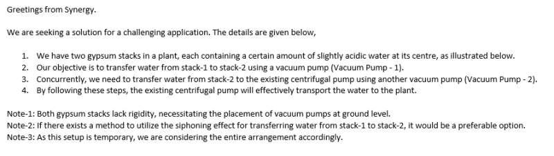

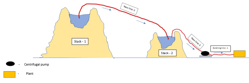

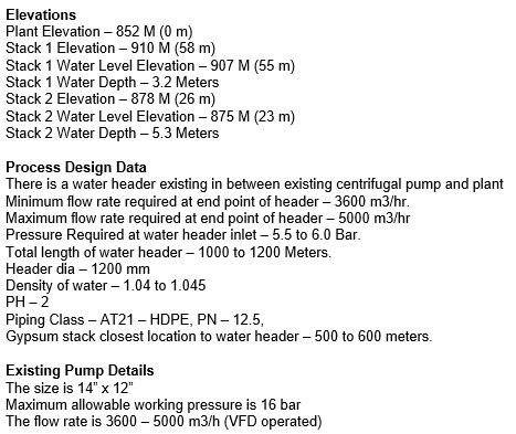

required a vacuum pump, how to select a vaccum pump which suits my application and how to get a supp
