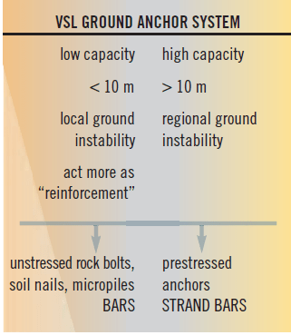

I agree with your comment a pink star for this explanation.. but not always true.. The regular grade rebar still used for pretensionning of PC elements and post tensionning of 'massive elements' such as pier caps. Regarding the use of ground anchors, the following picture ( snap from VSL Ground anchor systems ) is good guide for selection of regular grade rebar vs strand rebars.
One may look to the full doc. attached :

No... the round bar .. to differentiate from strand . In my region, S 950/1050 (MPa) , (equivalent to grade 150 ) is used for prestressing . However, the use of S 42 ( grade 60) is a common practice for passive anchorage, soil nailing systems.

You did not mention the type and purpose of prestressed ground anchors ..
The type of anchor should be decided acc. to tolerance of the supported system to the anticipated deformations of soil with relaxation of the prestressing ..
You may choose regular grade (60, 75) REBAR for passive anchors or soil nailing system which these are IMO ,essentially slope protection measurement rather than retaining..
If anchorage system is for soil retaining of a deep excavation at a city center, you should prefer prestressed strand system.
For rock anchorage ( the loss of prestress will be limited ) , you may choose prestressed anchor bar with grade 150..
If the anchor system is for bouyancy ( against floating ) , IMO, prestressed micropiles
with grade 150 is better..
