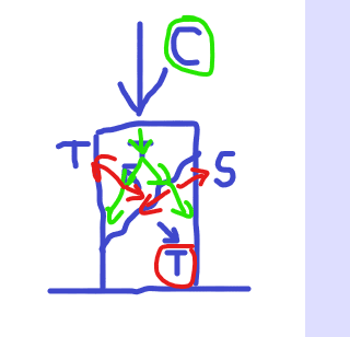

Similar to the shear friction, there are tensile forces on each side of the shear plane, that is where the T's coming from. I don't think truss analogy is appropriate, or adequate to address the problem here. Mohr's circle, yes, and engineering mechanics should be the best resource for answers.

Considering just about every major concrete design code in the world suggests that axial compression improves shear strength, I think we might believe them. Shear is caused by a combination of shear strain and flexural tensile strain, and axial compression reduces the flexural tensile strain.

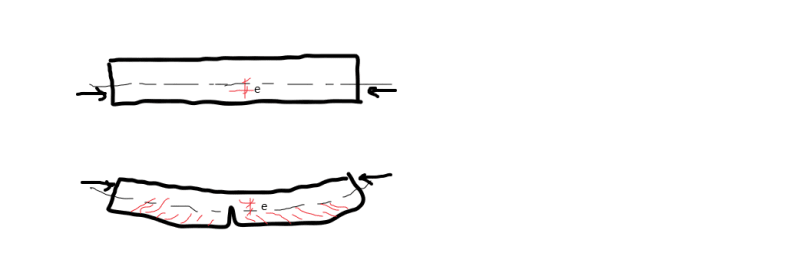

Compressive force helps horizontal structural elements such as beams if applied in the geometry center, or off center in direction opposite to the gravity loads that produces bending, by limit the development/intensity of the flexural stress. If it is applied in manner contrary to stated above, flexural stress increases, and shear failure occurs that leads to ultimate failure of the element under concern.

For argument on effect of compression on flexural members, see the sketch.
