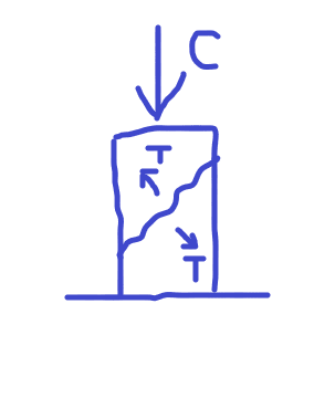

Shear phenomenon is caused by compression. Remember in concrete lab to verify the shear plane by compress the cylinder to fail!?
retired - we used a beam with (roughly) constant moment to test shear. Compressing a cylinder on the side tests for a transformed tensile failure.
I think this is the usual way in concrete lab to determine compressive strength of the supplied concrete.

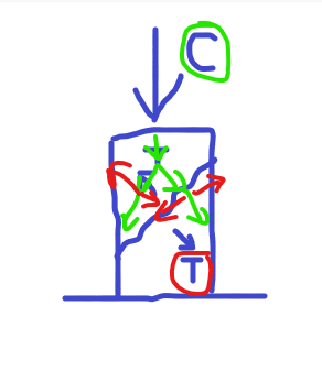

Retired,
That type of break is not the ideal break in compression tests. A proper test results in stresses something like this. Mohr's circle and all
The shear crack will propagate then leads to crumbling of the specimen. The point here is compression causes shear to occur, or depress shear force. I would agree that the compressive tends to close a gap AFTER a gap is formed, similar to the effect of post-tensioning.
