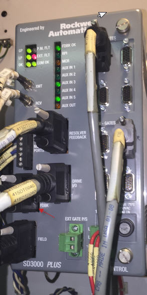

Have removed the earth from the RC and now find another....on all the drives on the cranes.
See attachment, I remove the armature feedback cable as shown byred arrow and no more earth faults.
With all other cables removed apart from the armature feedback, the earth fault is still present, therefore i believe it is in the Rockwell module somewhere.
