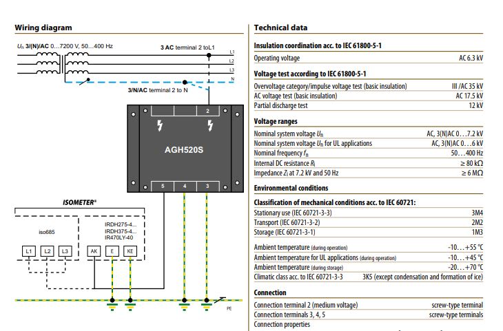

Does any one have experience with the Bender module for medium voltage?

I've seen this a few times. It injects a sub-harmonic signal through the generator and reads it to see if anything is grounded. I know ABB used to make one version, not sure if they still do. I think Beckwith Electric also makes one.
Here is a paper on the topic:
SEL makes one as well, I thinks it’s the 2660S. As you probably know these are really to achieve 100% stator protection on high resistance grounded generators - the 59G voltage element can only be set to cover 95% of the winding, without a 3rd harmonic element or a injection system you can’t protect for the last 5%. We typically use the 3rd harmonic element because it comes with the SEL generator relays, but one model machine in particular doesn’t generate enough 3rd harmonic voltage, so we have looked at the 100% protection for future installs.
I’ve used a 480V Bender IR relay, but that was only for an ungrounded bus. Does your generator have a high resistance neutral connection?
We have them on 5,1 MW , 1200 V , DC motors and they have proven to be very reliable. Recommendation .
