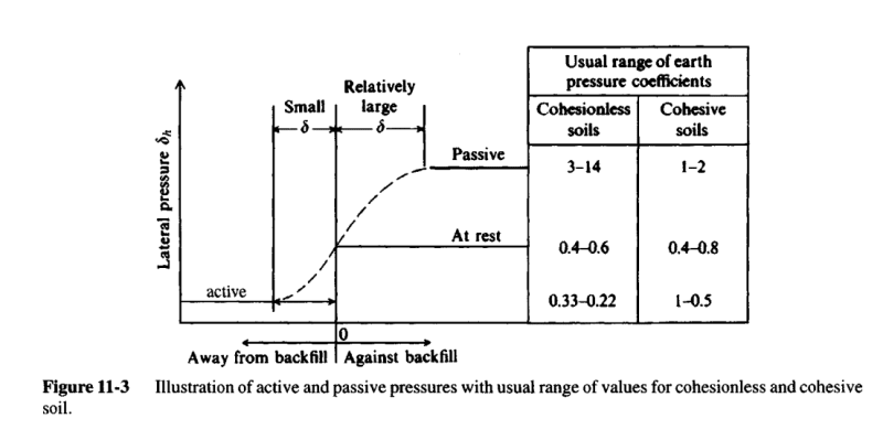

Picture may be better:
Open Source Structural Applications:
I get what you're saying Celt83. I believe this graph will add to your sketch:
The active "resistance" pressure is confusing to me (and probably others) because I've never seen anyone do that. I have (and seen others) ignored or discounted the passive pressure by a FOS but never say that it is equal to the active pressure.
