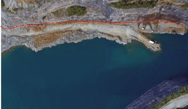

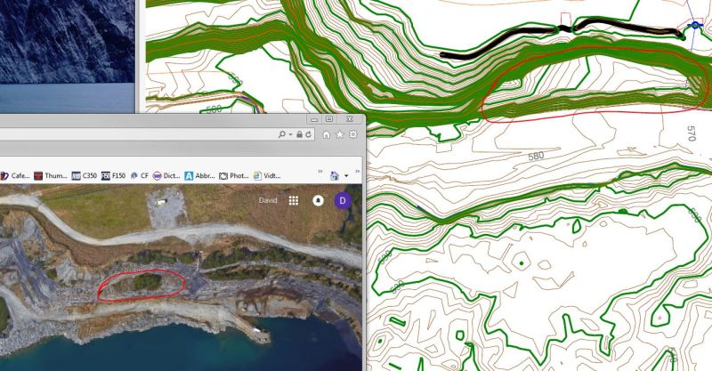

Yes that certainly clears that up. The water looks to be at about 560. And NOW I understand, are only going to the area marked with the red lines at your 584 mark.
Which explains why I was not seeing this little flat area between these two shear walls
Your data just goes up to that first wall.
In this case I agree with your data sets being on 2unit (thinking feet per above) intervals. This still leaves the plan coords in meters and contours in feet issue to resolve. And I still believe the plan units are most likely meters based on your 615 x 510 surrounding box and a 2000 x 1500 foot looking Google maps plot area.
