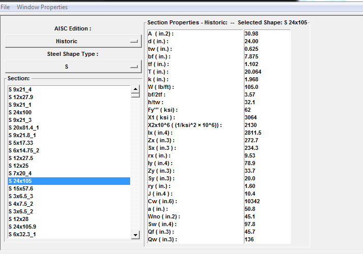

Can anyone tell me where I can find the section properties of an old S24x105. 1918 vintage?
I am only able to find sections that are very close in my historic manual collection (S24x106, S24x104.5, etc.)
Have you checked AISC's historic shape database?
That old I am not surprised you can't find accurate section properties; I'd field measure the beam and calculate section properties yourself.
Ian Riley, PE, SE
Professional Engineer (ME, NH, VT, CT, MA, FL) Structural Engineer (IL, HI)
from the historic database:

Following what canwesteng mentioned, does anyone have a detailed drawing or information on the dimensions of S-beams. The tapered flange, lack of toe radius information and where exactly the average flange thickness is applied makes it impossible to make an accurate drawing of an S-shape. Surely there is a profile somewhere. How else would manufacturers know if they are making it within tolerance?
Interestingly enough, the properties provided by Celt83 match identically with properties provided in the first edition AISC Steel Construction Manual for a 24Ix105.9. The properties also exactly match those for a 24x7 7/8 American Standard beam that weighs 105.9 lb per foot from the 1934 edition of the USS Pocket Companion.
