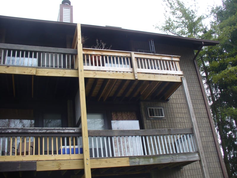

Here is One more for the party - Some 'repairs' at an apartment
These boards are doubled so not as bad as yours? But both plys are spliced like this, so even worse somehow? Anyhow, All of these decks were fully replaced.

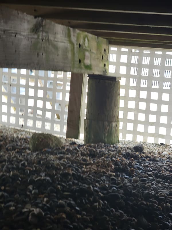

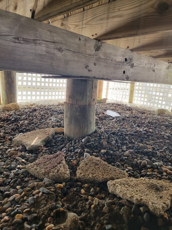

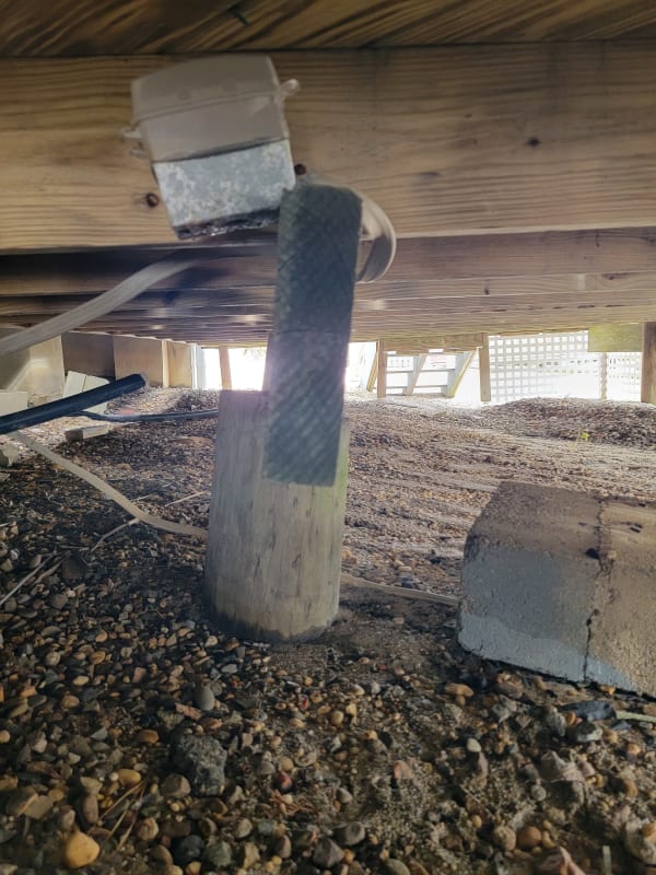

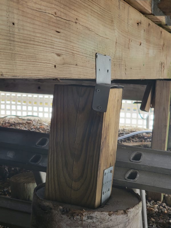

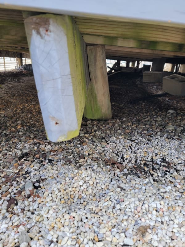

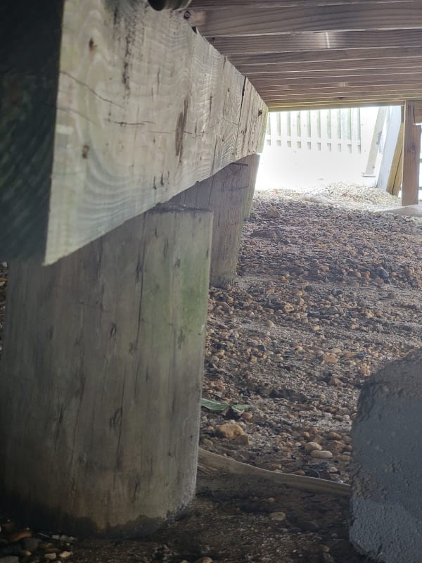

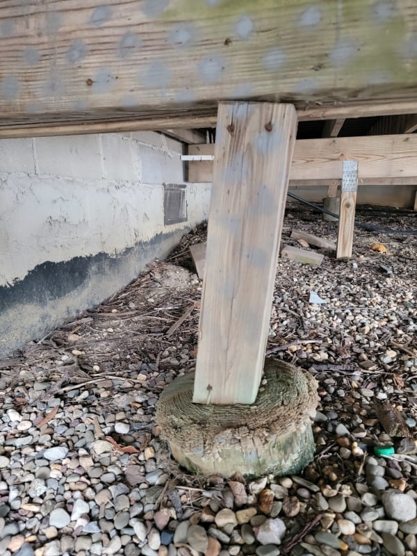

Check out these "foundations". Yes that is a chunk of timber pile on top of another pile. Yes that post is hanging from the beam, along with the sonotube below; it's literally floating above grade, you can swing it back and forth. And the #1 botch job, the main row of piles we suspect are only in the sand a couple of feet because they are leaning close to 30 degrees off vertical, pulling the entire deck away from house with it which my little block of wood from the OP was trying to hold back [lol].
