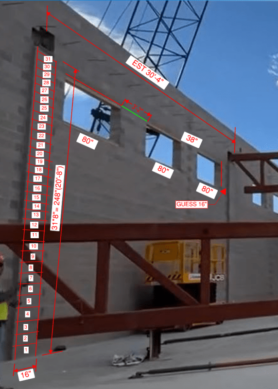

JLNJ, Steel Truss should bear on embedded steel plate that is on top of horizontally reinforced concrete/grouted bond beam, and not lintel block outer edge. Drawing above shows this clearly. Joist is resting on reinforced grouted portion of lintel.
Brad, I realize you are guess at block size of wall, and from images it appears that pilaster is about 2" deeper than wall. 10" and 12" blocks would fit that scenario....
It appears Hollow Core Planks only require 3" of bearing depth, so my question is how much bearing depth does a very large steel truss point load require and well as width? Even when blocking mobile homes, aka trailers, in my teens, we never bottle jacked directly on a the concrete block..... We always spread that load with at least a 2x8/10/12 depending on block depth.
Perhaps adding a blue pilaster line and extended rebars would explain why tension horizontal rebar is not directly under extended grouted area of pilaster, whereas if full 12" deep wall, rebar locations would be in better location to assist in spreading bearing load evenly.
Just because you found a detail online that shows a truss supported a certain way doesn't mean that is the only way trusses are allowed to be supported...
Never said it did, but it is hard to explain the top of block pilaster been destroyed if the metal plate extended out over block edge. The whole concrete block pilaster design looks like a very poor design choice...

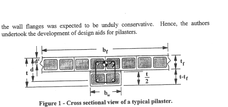

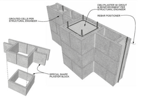

So it is clear, below is what a pilaster typically looks like. All you are showing in your wall section can be done at the head of the pilaster. Pilasters generally serve two purposes. The first is to support large point loads, and second is to allow for a thinner wall section or less solids in that wall section. I think the scale of the images makes it difficult to discern dimensions.

Brad in your typically concrete block pilaster cross section, how do you put the rebar stirrup wraps in a masonry pilaster wall that just adds another equal width block adjacent to wall, where you have a point load?
I can see cutting out sides of block between wall and pilaster at stirrup locations, perhaps that is solution?

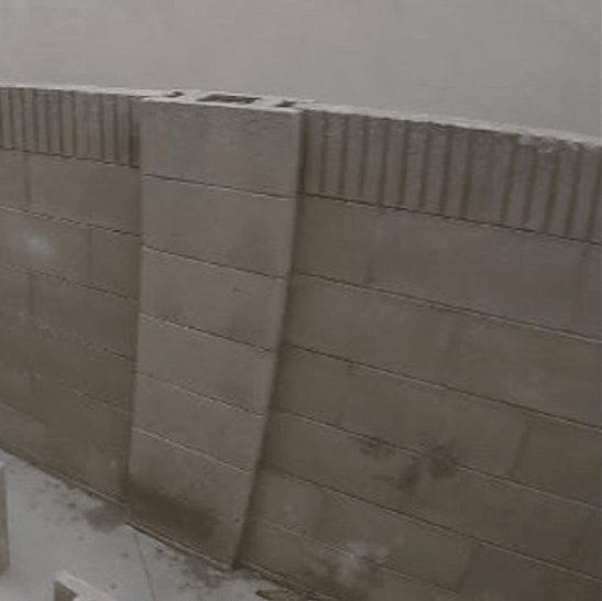

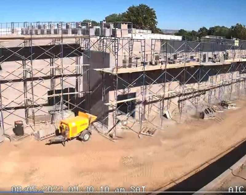

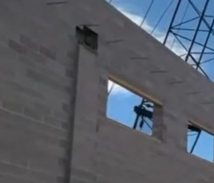

Also now way can I see more than 2-4" protrusion from wall of pilaster, from the low resolution images, rather than another 8 or 10" block pilaster. Looking at construction sequence on KOB, it appears they are stuffing more steel in block cores about every 4' of height, with more in area of point truss loads.
Can't tell what is going on with pilaster, but it appears it is being laid at same time as wall. From images it appeared to be they just laid in deep block at pilaster area, then filled cores.

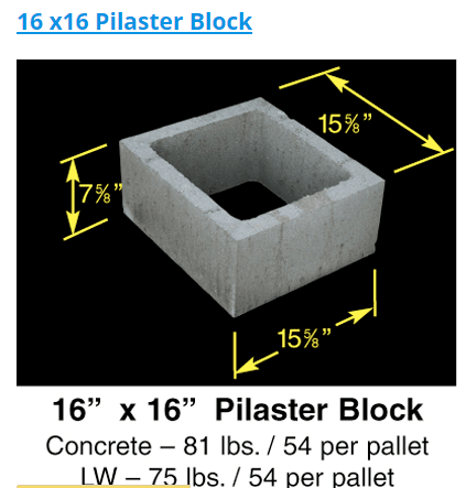

That image was from a tech journal I found. Many professors are not great at the building. Below is an example of a pilaster shape you can buy. There are other ways to make them to. The primary goal is a reinforced concrete column of known higher strength.
Still from one of the construction reels which appears to show U-shaped blocks.
The wall appears to be constructed using 8" units...
If the pilaster were masonry, most engineers would design the bearing with the support centre of the large truss falling on the centerline of the pilaster or on the centroid of the composite wall-pilaster section. They would avoid eccentricities for the large truss load. There would be a steel bearing plate of sufficient area to accommodate the bearing with headed studs or welded rebar going into the pilaster. Depending on the code, the composite section would be determined by the pilaster width + 12 x the thickness of the wall or the height of the wall / 12 + pilaster width, whichever is less. Strength would be determined on this... This composite section should easily be capable of supporting roof loads (I'm not so sure for HC slabs which weigh more than 2x a regular roof. This is based on experience with regular roof loads for a building of similar geometry. Pilasters designed properly can easily work for normal roofs.). The pilaster would be designed as a regular masonry column with windload plus a nominal eccentricity from the truss... that's the way I would have designed it (we don't have significant seismic loadings in this area). No rocket science and design level of difficulty out of 10 would be about 3.

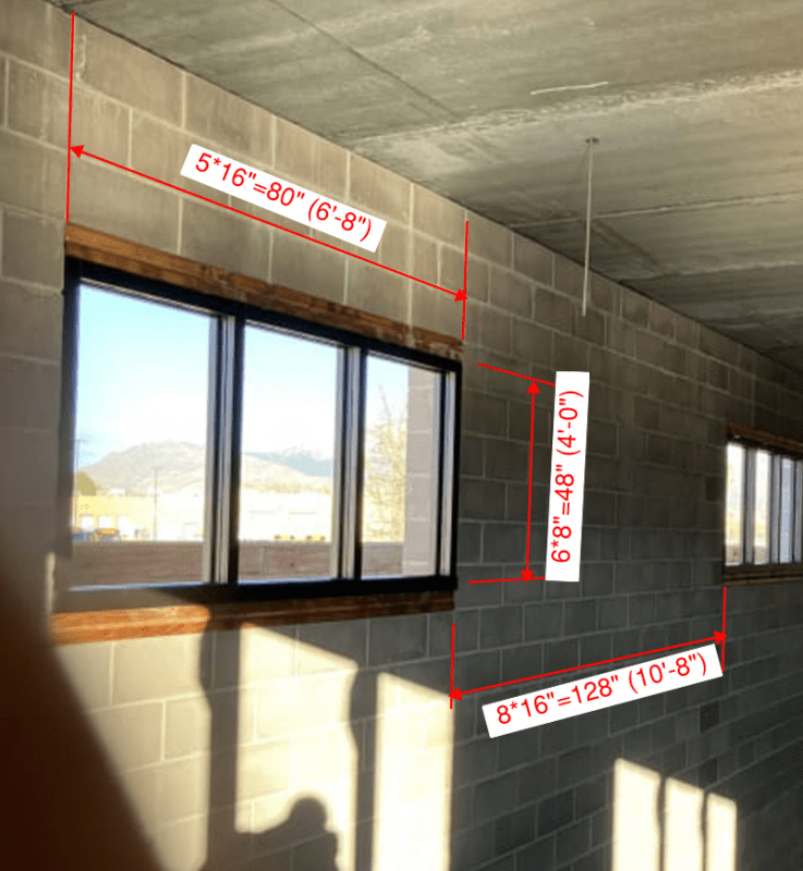

Looking at a the window jamb picture closer again, it could be 8". I sketched my guess below.
Assuming the window sizes shown in the image below is the same along the side in question, I estimated they are 80" wide. I do not see any better pictures to estimate the space between windows, so I scaled the image. Given the perspective, this could be wrong. I estimated the space between trusses is 30'-4", which is close to Tom's google earth estimate. Counting blocks, the bearing elevation of the truss seems to be approximately 20'-8".

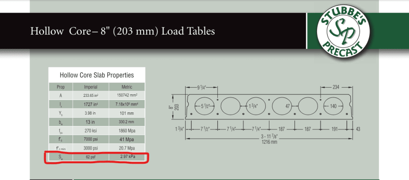

Assuming 8" Hollow Core slabs, their weight is 62psf from Stubbes. The topping thickness seems to be in question given the slopes discussed, but maybe 3" average or 37psf???

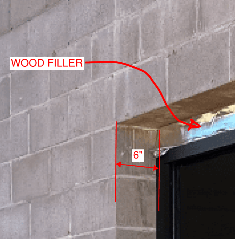

Two things:

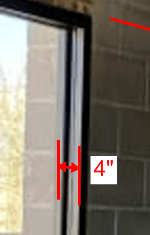

If the spposition is that the CMU's are 8" deep and your estimation is that there is a 6" reveal at the exterior of the window frame, that leaves 2" for the frame depth, which is rather shallow.
If you are using the wood window opening liner as a frame of reference and assuming double 2" standard lumber sizes, in other words a 3" liner, that is consistent with your previous estimation.
My guess is that the liner is actually augmented with a layer of 3/4" plywood (see image above, particularly along lower sill). Proportinately, the window frame depth is closer to 4" and thus, the CMU's are 10" deep.
Further, the reveal of the pilasters is quite shallow so it would be reasonable to believe them to be 12" deep and provide a 5 or 5 1/2" seat on either end for the girder.
Even further, it appears that the seat plate protrudes from the pilaster maybe 1/2" providing ample protection for the CMU lip.
The window frames look like 4" aluminum frames I see all the time. I suspect the wood fill is 2"x4" material. The main reason I posted the info was to entice Dik to run thru an analysis to show that the pilaster is feasible as many of us think.
Do you agree that the likely block depth is 10" with a pilaster depth of 12"?
A masonry reinforced concrete pilaster similar to below above, at correct size for 30' tall column, with bearing capacity to support very large point load, should work fine....Lost my bearings again!
BUT, that does not 'appear' to be the design we are seeing in the limited images and videos we have available to evaluate....
I wish I could find an image of what it appears to be in my head......
OK, image below is NOT totally accurate, but it conveys concept of just inserting 12" block in 10" block wall to add bearing area for point load. Then capping it all with U-Block Bond Beam. Trouble is you end up with eccentric load at 'Bumped Out' pilaster appearance area...... and continuous wall bond beam reinforcing is not concentric with point load bearing area.
