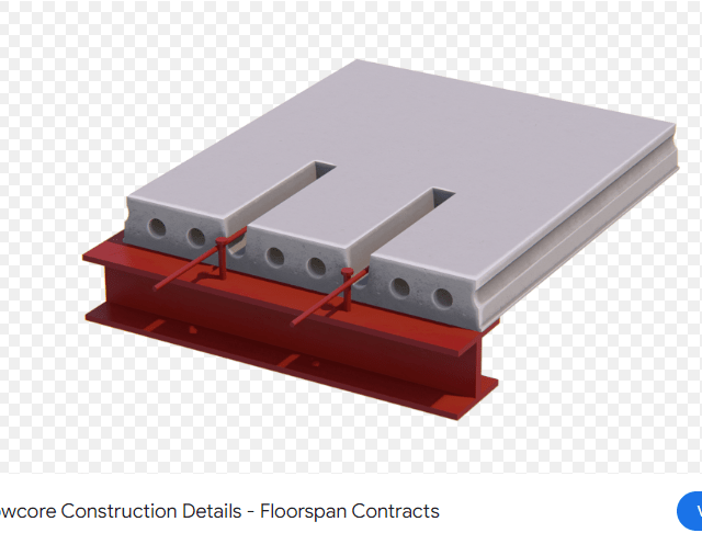

Dik, every steel bridge with precast slabs I have seen uses studs. I would use them in a heartbeat. With todays modern technology it is not difficult to accommodate them in the design. This connection is super critical to the truss performance as you know.
I would guess that in all common sense they didn't pour the topping knowing there was a dip in the girder. There is evidence of the topping layer and some cables in the imagery. In any event, the insulation and membrane have to be held down either mechanically, glue or ballast. Does anyone know how this membrane is secured? Also, what is a spring tension system for the topping? Is that just supposed to relieve the weight of the topping? How much tension can be loaded into the parapet? Many questions from the uninitiated. I didn't see anything on Google.
To be clear, we are talking about a topping layer above the insulation not as part of the hollow core base?
Different details of construction; when was the last time you saw HC slabs used for a bridge?

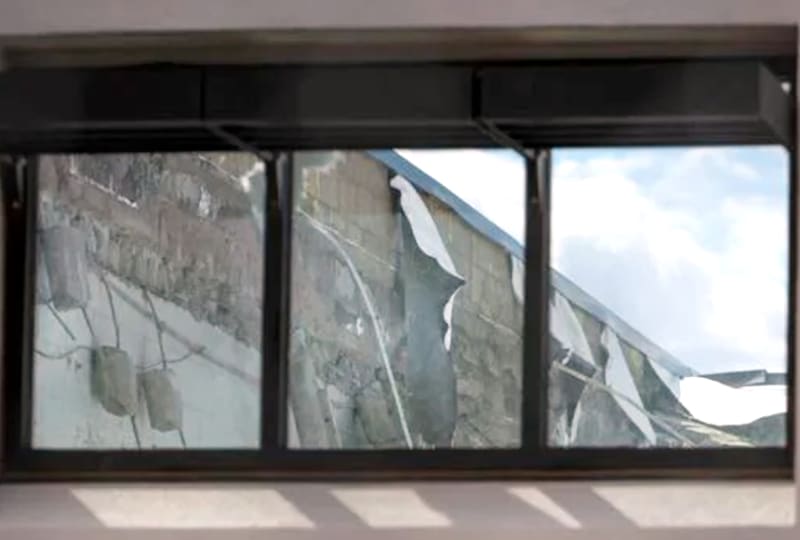

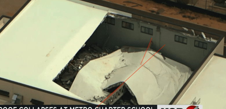

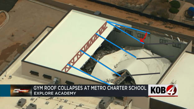

Regarding the truss ending up North of the support column. I suspect when the truss lost its bearing, the roof and truss assembly likely pivoted northward around the intact truss, due to the northern end of the failed roof still being connected there.
Yes, Dik, bridges do not use hollow cores, but we can use the same concept with this. Regardless, we are going off topic.
As previously posted, torsional buckling of top chord makes a lot of sense to move top chord laterally off floating bearing surface, and perhaps the asymmetrically draping and break up of the roof deck provide some more clues?

Except it may be the bottom chord. The top chord is more likely to be laterally supported by the roof deck, while I have not seen any evidence of lateral support of the bottom chord.
Yes. My bet is still on the movement of the bottom chord as the primary trigger to the column being pulled off its support. AKA LTB of the member The reports of inspectors seeing the truss "dipping" is on piece of early evidence. The fact it occurred at such a low load is another along with the truss seemingly mostly intact.
I suspect it simply fell off or slipped off the seat, perhaps due to a bearing failure or similar, as opposed to it buckling off the seat. We’ll find out soon enough once we get more pictures and details.

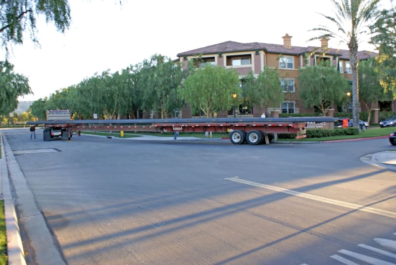

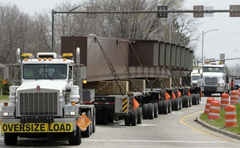

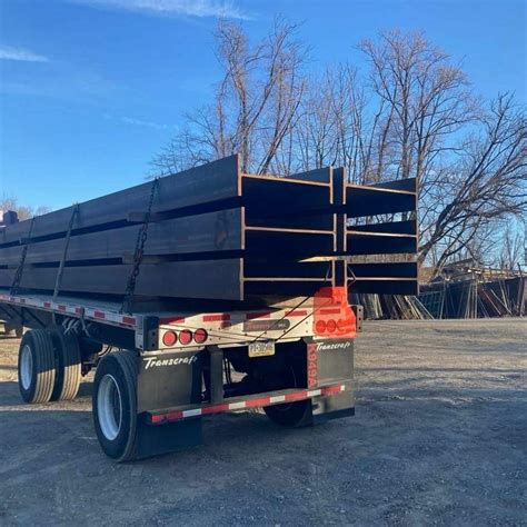

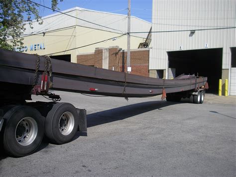

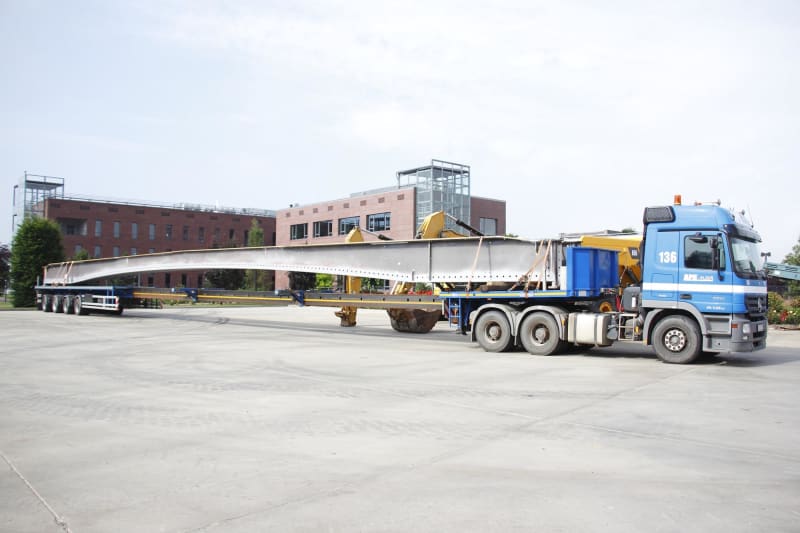

How 'did' they transport the large metal truss from fabrication to job site?
I have seen how they transport wood trusses to job sites, and they are laterally bent in all directions during transportation to job site.
How was truss stored at job site?
So could you bore-sight align truss before and after erection?

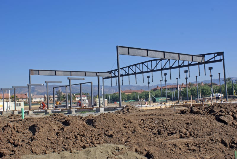

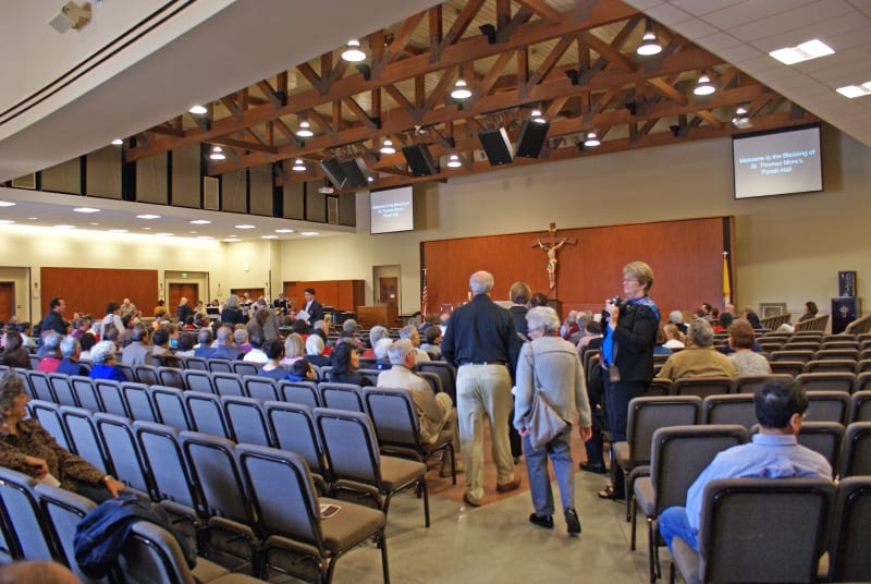

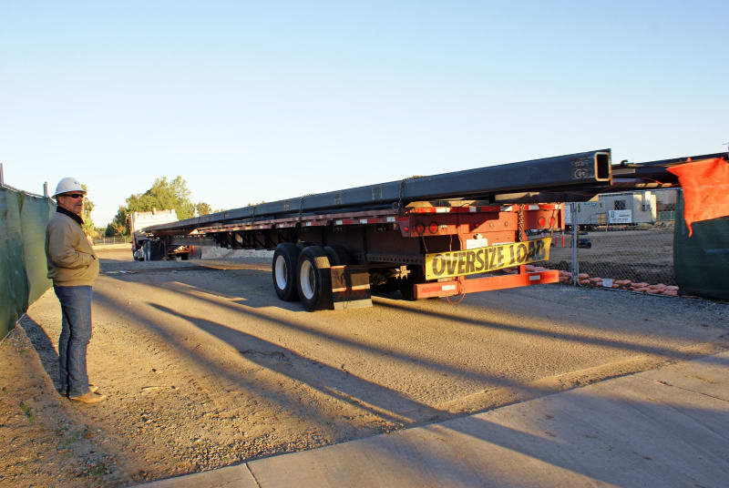

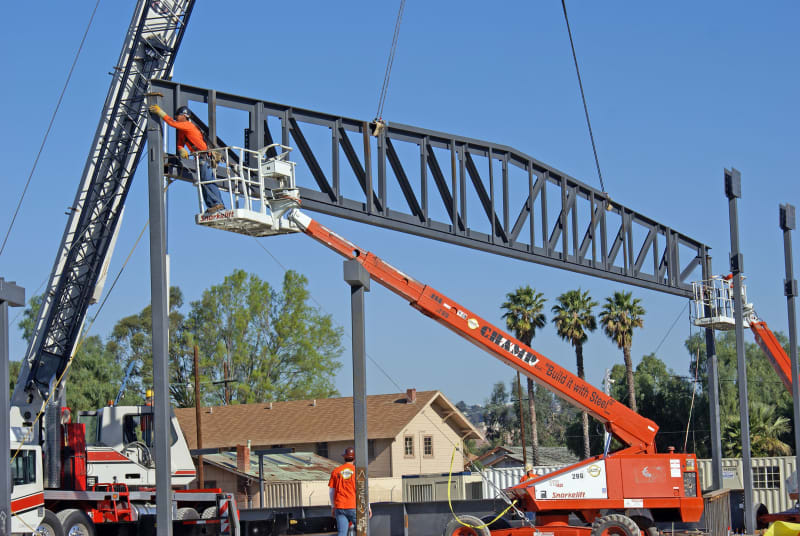

When they built our church 15 years ago, in addition to being on the building committee, I documented the construction for our parish records, going over to the job site every couple of days or when anything significant was taking place, such as the day they delivered the 80-foot long main truss for the building, as seen below:
January 2009 (Sony A100, 18-70mm)
And I was back the day they placed it in the superstructure of the building:
And when the basic steel superstructure was completed:
And when they had installed the wooden cross trusses, which was the main support for the roof:
May 2009 (Sony A100, 18-70mm)
And as you can see were exposed to the congregation (this picture was taken the day the building was dedicated):
January 2010 (Sony A100, 18-70mm)

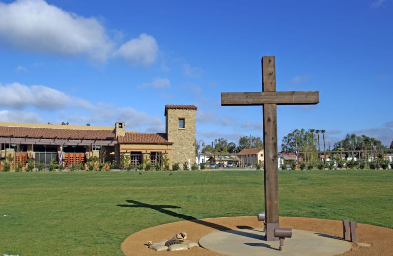

And here is what the building looks like on the outside:
March 2010 (Sony A100, 10-24mm)
Note that this building is located in Southern California and therefore had to be built to strict earthquake codes.

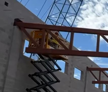

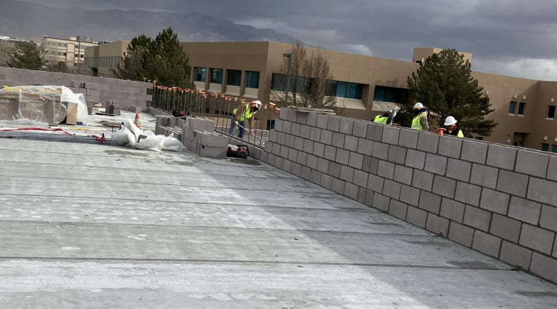

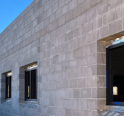

What actually connects the concrete slabs to the wall and what connects them to each other resting on not a large bearing surface on the trusses.
There are some photos on this, but I can't see how the concrete panels are supported onto the CMU wall.
Did the blocks fall / fail first and then dragged the truss off its support or vice versa?
Maybe we'll never know as there isn't any public ally available CCTV footage.
Could wind load have lifted the roof through the open windows and displaced it?
The panels sit on the block wall and the parapet is built up on top, at least on the ends. Rebar and concrete plugs are used to secure them, visible in the damaged remains.
Facebook
Hmmmm,
In the faceboook photos, the roof panels look about three blocks wide. Yet on the external shot of the same location all you see three block up from the top of the window frame is blocks.
So what are they actually sitting on? Half a block?
Yes, they generally hold them back a few inches. That lets them a) hide it in the block coursing on the exterior by placing just a face shell along the edge and b) allows them to grout the wall and the ends of the hollow core together. There will typically be a bond beam for them to rest on with bars coming up, and hooks going into the hollow core and turned into the plane of the wall. So when the grout it, the grout flows into the hollow core (the "concrete plugs" mentioned above) and engages the bars coming out of the wall, too. It works well under design loading, but it isn't designed to hang the planks from the wall so the plugs pulled out when they dropped.

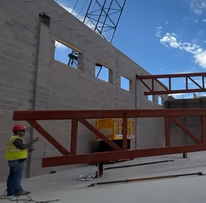

You can see in GreenLama's post above, that the bearing pocket appears to be enlarged to the left during erection, to swing truss into pocket. Looking close at the later image shows the pocket was enlarged more. Pay attention to above rebar relationship to the extended pocket area.
