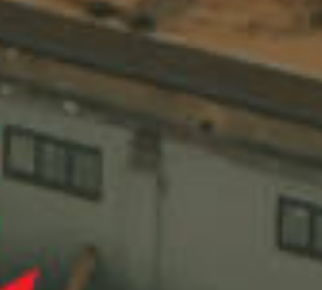

Is that a masonry pilaster in the wall for the column to sit on? or, is it masonry cover over a steel column behind. What is the truss support?
Based on the pictures way up above, it's a pilaster.
There’s a grey chunk at the top of the pilaster, at the otherwise white walls. So it could be a simple bearing failure of the pilaster.
With those trusses having to fit between the walls, the bearing length is only so much, presumably.

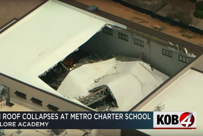

So a question I have is, Aren't the roof panels supposed to span (in the N-S direction from above) between the concrete block wall and the truss, and then between the trusses? If so, why do we not see in the failed image the truss that remained in place? It appears that there is an overhang. Is this just an optical illusion? You would expect that the roof would fail/crack along the center line of intact truss. From the image below it appears that some portion of the full roof panel is visible to the S of the truss. For reference I drew a line between the corners of the windows.

TheGreenLama - the planks failed with the truss, but there's probably a seam in the roofing material where it separated that doesn't line up with the structure. I'd guess the structure fell away but the roofing is still clinging together in those shots.
It does appear as tomh has pointed out, that the top inner portion of the pilaster has failed.
If the dip reported is deflection of truss, it appears that would lessen effective top cord bearing surface area, and thus put increased bearing pressure at the inner edge of pilaster.

You would expect that the roof would fail/crack along the center line of intact truss ... For reference I drew a line between the corners of the windows.
You can see a break line on the roof where the intensity goes from bright white to duller white near the edge of remaining roof portion on the left. The intact truss is at the intensity transition, which is consistent with the 3 windows being bracketed by the pilasters holding up the trusses.

phamENG - I suspect you are correct. As mentioned above, on top pf the precast panels there could have been additional insulation, a topping layer, and a membrane. Maybe what we see are a straight line seam in the membrane, with pieces of insulation hanging down. Not parts of the precast panel.
The planks did.
What you see is remnant roof sheeting and insulation. Hence the kink along the truss line.
There is a V kink in the truss/roof membrane, creating a saddle. The vertex of the saddle appears to be approximately in line with the square station (i.e., the segment lacking a diagonal). There appears to be gross deflection of the truss with the flexure point at this location. Under what circumstance would this disfigurement occur?
I suspect the fold in the roof sheeting is simply the cantilevering sheeting sagging over the truss line; The fold disappears near the ends of the truss because the sheeting is being held up by the walls here. The sheeting cannot fold down like it does at the middle of the truss.

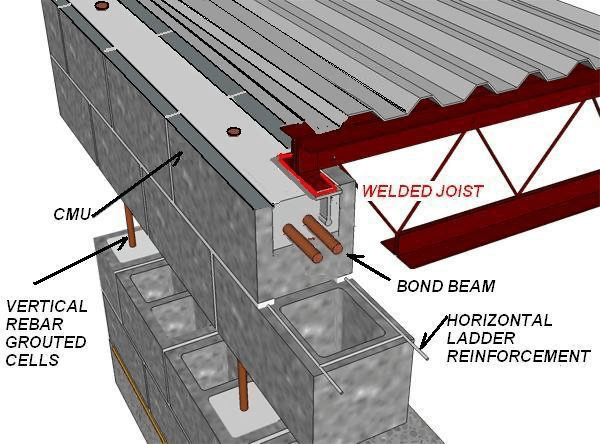

A typical detail option for the welded end of a steel joist, bearing on a masonry block wall. This concept design detail indicates that steel joist should have not been in direct contact with block pilaster (especially the masonry edge of pilaster block). All bearing area should be located on the poured bond beam.
Masonry pilaster damage could have happened as joist deflected, and pulled joist downward and away from bond beam bearing area, and as joist dropped to lower energy state.
Was the suggested 10" block wall too small in depth for required minimum bearing area of large long span steel truss? Thus pilaster added to increase bearing area, and perhaps placed some bearing area all the way to edge of block? Perhaps a Value Engineering offering from Builder to save money on 12" block without pilaster? This also places horizontal rebar further away form edge of block wall bond beam.
I don't understand is comment. The pilaster is exactly where the truss should bear.
I guessed at the block size. It could be 12". Again, need plans.
Pilasters are used exactly for this reason all the time. The truss reaction is in the realm of 140kip or more. That is not the type of load you put on a simple block wall in most cases given the wall height.
