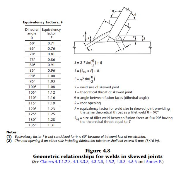

Just to clear up a bit of confusion on my part. I don't have access to W59. Is the minimum dihedral angle, for a prequalified fillet weld, 45 degrees or 60 degrees?
Figure 4.8 equivalency of fillets relative to 90 degree joint (F = 1.0)
Clause 4.5.6 said:
The relation between dihedral angle and the effective throat shall be as follows:
(a) 60° to 135°: the effective throat (E) shall be considered equal to the theoretical throat (T) (see Figure 4.8);
(b) 45° to 60°: the effective throat shall equal the theoretical throat reduced by 3 mm (1/8 in), unless a larger effective throat is established through procedure qualification (see Figure 4.8); and
(c) Theta < 45°: the effective throat shall be established through procedure qualification (see Figure 4.8)

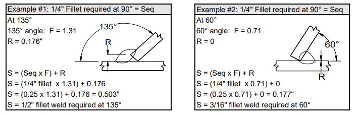

They are for the sngles on the opposite sides... thanks for the clarification, and the weld capacity would be modified by the F factor based on the fillet weld size. For example a fillet weld on a 60 deg angle on the RHS would have 0.71 times the equivalent 90 deg fillet weld. Is that correct?
It's the other way around. These are equivalency factors for leg length.
For example lets say you need a 6mm weld at 90 degrees. The equivalent leg length on a 60 degree joint would be S = 6mm*0.71 = 4.26mm. If you put a 6mm leg length then your capacity would be 1 / 0.71 (1.41x) as much as for a 6mm weld at a 90 degree joint. For the same leg length the effective throat is greater in a joint with a smaller angle and less in a joint with a larger angle.
thanks... I would have thought it would be reversed.

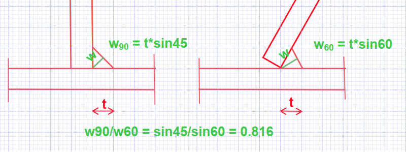

I believe the strength of the weld is proportional to the length of the green line shown below. Doesn't seem to be precisely equal to Enable's reference, but his is conservative.
BA
I realised that looking at the cross section shown that the acute weld was 'stockier'... and more robust... thanks... My inital thought was that the space was limited and the weld capacity would be smaller...
