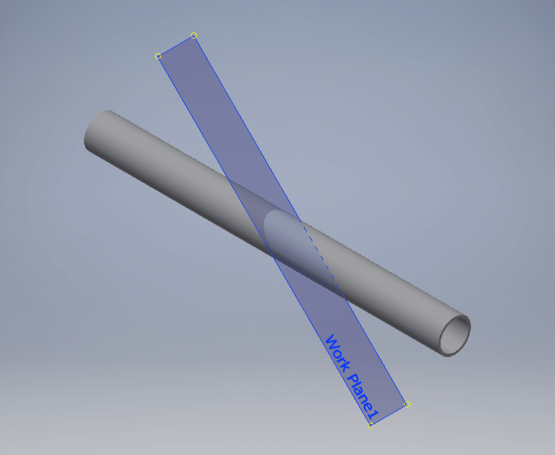

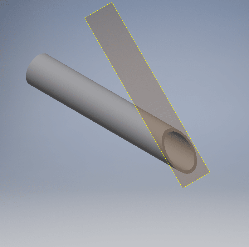

While my post does not provide the formulas to obtain the inertia of an inclined section of a circular tube, it's an alternative way to obtain the same result. I often use Inventor to calculate inertias of the sections of structural members.
Here's how you could obtain the inertia of an inclined section of a circular tube:
1) Create a tubular part:
2) Cut the tube using an inclined plane:
3) Obtain the inertia using the region properties:

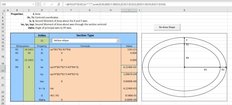

My section properties spreadsheet will do a hollow ellipse:
The example has the long axis set to root 2 x the short axis, with the inner ellipse with a radius 2 units shorter on both axes.
The observant will note that the results suggest that Iy = Ix = Ixc, which is obviously wrong. Since the origin is at the centroid of both ellipses Ix = Ixc and Iy = Iyc. I will fix that and upload to the same address.

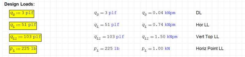

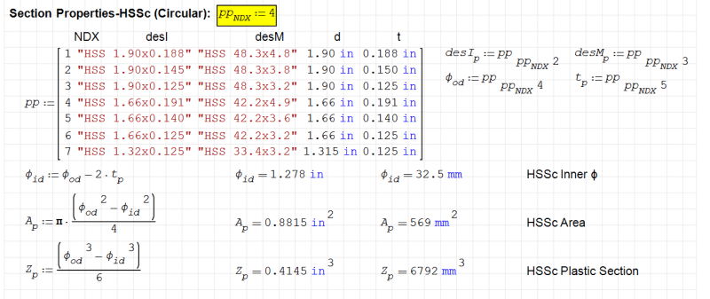

@ dik. Please, can you tell us the tube diameter and the design loads?
Regards
Very often the 1.66x0.125 is the guard post of choice and sometimes the 0.140 wall thickness (properties for the 0.191 wall thickness are shown).
and design loads (the data columns line up... just from different parts of the program):
