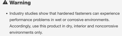

Them. Page 25 of the 2015 to 2016 catalog.
Yup, that is what I was referring to in my previous post. I don't think these are meant for exterior use.
I feel better about bolts in this application.
I don't see any such restrictions after a quick perusal of Simpson's catalog C-F-2023TECHSUPP.pdf. You can also get them galvanized (TBG). If your steel flange is greater than 1/4" thick (but less than 1/2" thick), you would have to go with the TF screw, which is not available galvanized. Seems a lot easier (and cheaper) to me than bolts. When the flange thickness is 1/2" or greater, I've used welded studs. The contractors I work with prefer welded studs to through bolts because the welding is a fairly routine procedure in a steel shop whereas a through bolt requires more work for the framer in the field.

You said screened porch, to me that's got a roof.
It does. 12" overhang. Should I also not use treated floor joists ? Rain can fall at an angle, go thru the screen and down thru the boards. How often? Probably not enough to make a difference but still.
Can they close it off with glass at some point? I was picturing a three season jobby and those all have glass, or could. Exposed to rain isn't quite the same as "wet environment" but i can understand caution or skepticism. But if you're being consistent, then all the connections get those 40 to 60 percent reductions via Cm.
Most of these have at least occasional drying, and aren't saturated. Of course make your own decision on the circumstances. PPT wood is pretty hostile to connection materials, and hangers, too.
Certainly they could. i did not design for that additional lateral load but the plan reviewers around here a pretty good about flagging that if the time comes. They can add some bracing then. There are only so many contingencies I am willing to include in my plans.
No screened porch around here will pass a framing inspection w/o PT wood and the requisite hardware.
