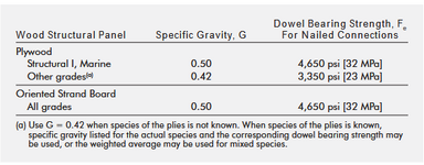

I was thinking about it this morning (because I'm a nerd and have nothing better to think about, apparently), and I bet it does work, even with SPF. The purpose of the plate is to pass the shear and uplift from the sheathing above the joint to the sheathing below, as it's already passed out of the studs. So the primary concern will be the nailing of the plate to the sheathing, with the penetration into the studs serving to improve the connection behavior over a simple 1/2" embedment. If we assume that the sheathing to stud nailing is sufficient to have them act together, it becomes a question of the nail behavior through the two layers of "main member". The important part of the connection will likely have a G = 0.5, giving a better connection value. It would likely be less than the listed value for SP in the Simpson table, but I'm guessing it would be higher than the SPF value. One of those gray areas that live between the discrete engineering world and the prescriptive world...

So OSB has a G of 0.5? I never figured that.
