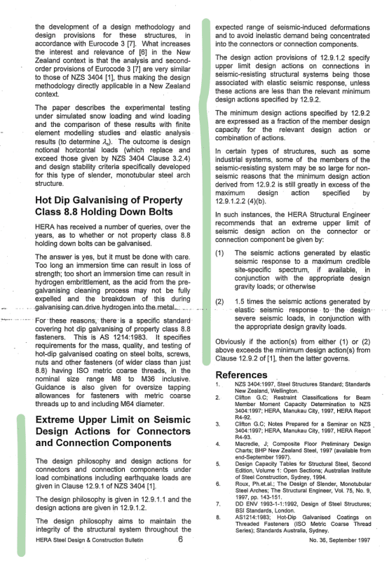

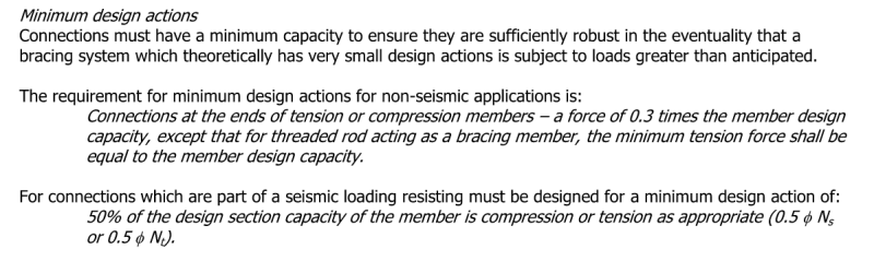

I did find this in some SCNZ literature which makes the distinction between member and section capacities for non-seismic and seismic respectively. Which suggests phiNc member capacity would be used for non-seismic, but also implies phiMb vs phiMs as well for non-seismic if you take the argument to the limit... but nowhere have I seen anyhting regarding member capacity = phiMb for flexure, they all seem to be interpreting member design capacity for flexure as phiMs, when this is the section design capacity...
ALso see this advice, for seismic the option is there to take the max MCE actions as an upper limit if the actions are low, but the sections are grossly oversized.
[from HERA DCB36]
We I posted at a pretty late time last night, I actually didn't quite grasp the distinction being made between member capacity and section capacity. But having another look, it is pretty clear that is another aspect of confusion in the whole piece. I've always assume section capacity as that is what has made sense to me but the text quite clear refers to member and not section. Additionally the exact phrase "member design capacity" only appears a small number of times in the AS4100 and only in regard to connections. Where it appears in seismic sections it seems to make perfect sense but it seems out of place in the non seismic connection design minimums. And NZ3404 situation isn't too much different.
