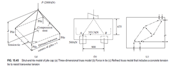

-ACI 318 allows the use of STM for deep pile caps .( R13.2.6.5 An example of the application of this provision is a pile cap similar to that shown in Fig. R13.1.1. Pile caps may be designed using a three-dimensional strut-and-tie model satisfying Chapter 23...)
- There are experimental results that clearly indicates that the STM predicts the behaviour of deep pile caps more accurately. There could be modelling problems of the strut elements with a single compression element. The compression force at struts in deep pile caps in general is not the reason for failure by crushing of concrete. But failure occurs after the compression strut splits longitudinally due to transverse tension caused by spreading of the compressive stresses.
- This can be seen with a refined strut-and-tie model as shown in below Fig. 15.45(c) copy and paste from NARAYANAN,
- The use of transversal reinf. will improve the resistance ,
- Other failure modes should also be checked as MILKSHAKELAKE pointed out.

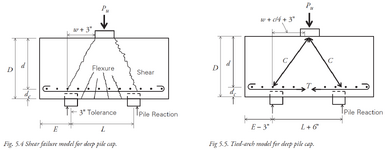

CRSI has the following limit states to check. Some of them are based on the column (limit states 1 to 6) and others at the pile (P1 to P4). Some of them are deep beam shear. I use an enveloped approach with FEM and also checking the limit states.
Source: CRSI Design Guide for Pile Caps first edition.
There is also a tied-arch failure mode near the column. CRSI recommends 180 degrees hooks as a precaution against this failure mode. Though in my experience, contractors find it difficult to make these hooks, especially with larger diameter rebar.
