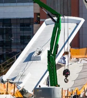

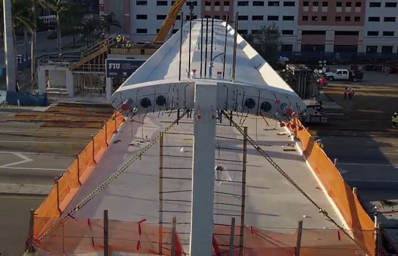

On another note, Philadelphia Construction Engineering on his youtube channel points out that only 4 of the six PT strands were tensioned in the canopy making the canopy "soft" around the blisters. Link
While not extensive there is spalling on the top-inside face of the pylon.

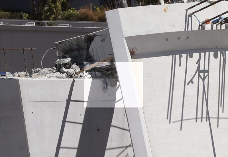

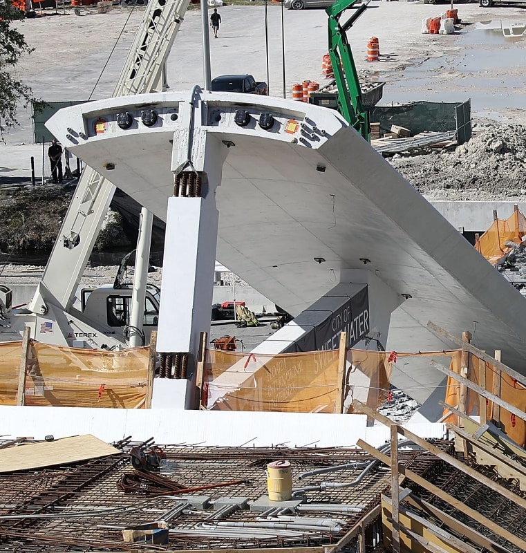

[...] (2) I don't have facts on this one but chipping out obstructing concrete to access the PT rods and nuts. Such work would need permission from the consortium engineer team. The NBC investigative reporter Tony Pipitone said the initial tension adjustment had been executed before the road was re-opened. The contractor might have sealed the pockets with mortar, temporary or permanently, to protect the steel from rusting. Once the tension adjustment has been completed the consortium has no reason to reopen the access pockets.
chris snyder (Electrical)29 Mar 18 02:27
2) I can't find good photos (wanted to compare how much thread was exposed), but the 2-3 blister was also chiseled open. And not sure how much, but chiseling up top would send impulses to lower end - not good if 11-12 to deck was cracked.
It appears the lower blister is grouted.

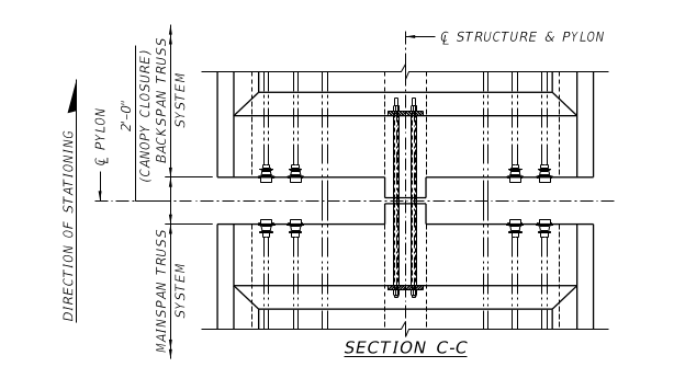

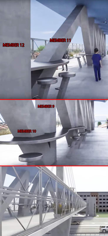

You might have something there. All the original concept drawings show 6 tendons in the top canopy. Your picture from the South end shows only 4, but with the inner holes there, but not filled.
The Northern end though looks a completely different end design, maybe because it was going to be filled in or connected to the canopy on the second span. There is certainly a lot of spare re-bar sticking out see below. The longer grey tubes look like they might be drain pipes, but clearly different from the tendons. The fact that the South end clearly has the holes made and ready for the tendons and North side doesn't implies something changed during construction.
So maybe the initial failure was at the top of 11/10 and not the bottom of 11/12. It's always been 50/50 in my mind. With a worker on top apparently reporting hearing a "cracking noise" just before he locked in his harness ( whatever that means) and seconds before the collapse might imply some failure closer to the canopy section than the floor.

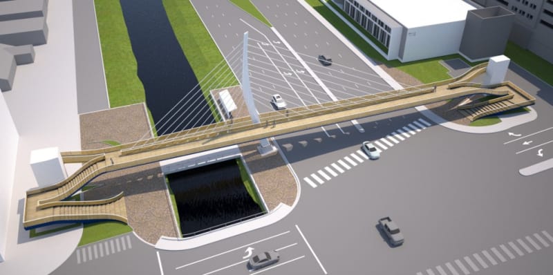

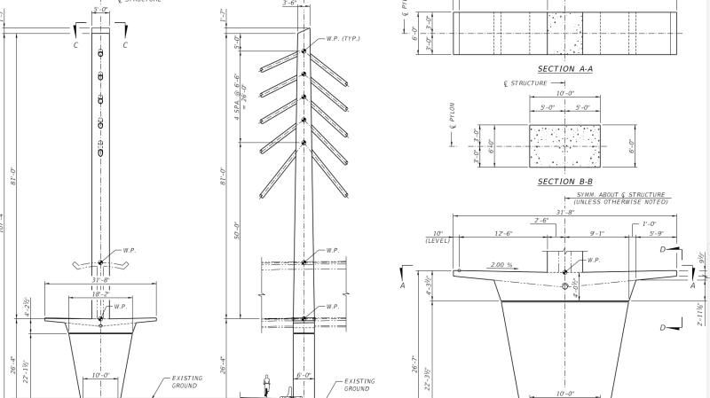

Still photos of the Bridge Deck (Completed Rendering).
Still photos of the Central support tower (Completed Rendering).
The photo on the bottom here looks like the concept design might have been a true cable stay bridge, I have a feeling the replacement bridge will lean towards it.
They obviously aren't photos of the bridge (completed). I don't know why you think those pictures suggest that the bridge was to be cable stayed, any more than what we already know.

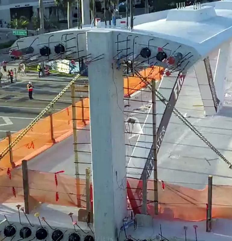

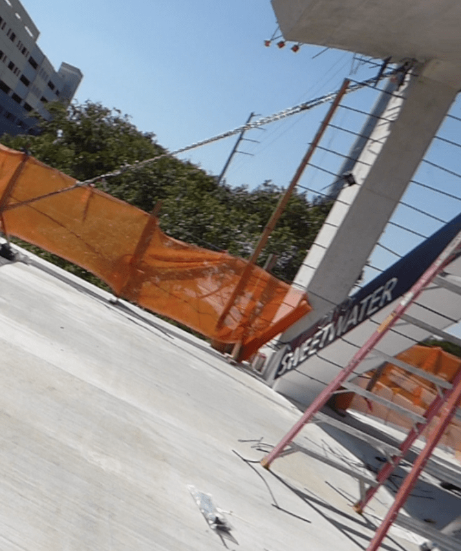

LittleInch (Petroleum)29 Mar 18 09:13 & epoxybot (Structural)29 Mar 18 05:33
Thanks for your photos on the two bridge ends.
It now seems
(1) The 6 PT strands have been reduced to 4.
(2) The unused 2 outer strand canopy positions may have been used for connecting the drainage between the two spans.
(3) Blister on top of #10-11 was sealed prior to the collapse
My experience would confirm LittleInch query of the extra rebar or starter bars at the north canopy. The drawings show #12 has a 12" extra concrete beyond the deck's edge. This appears to be used for bolting up with the second span which has exactly the same design. The 2x12" void is indicated as (2-0" canopy closure).
The same arrangement can be seen on the deck. The sticking out rebar or starters bars should be for the second stage concrete when the 2' closure is filled.
Additionally for constructing the 81' tall by 6' wide by 5' deep pylon, for connecting the stayed pipes, #12 will be enclosed by concrete on 3 sides (east, north & west leaving only its south face as the final finish). This explain why
(1) there are 9 vertical starter bars cast below as well above the north edge of the canopy, apparently for providing vertical reinforcing steel continuity between the column below and above the canopy. The 6' by 5' column below the canopy will encase #12 on 3 sides.
(2) about 14 horizontal bars on the east and south face of #12 (bars are close to the south face and were tied to timber during the move), this should be for the continuity of the horizontal links or stirrups of the pylon which is clearly has to be a reinforced concrete column design.
(3) starter bars sticking out on either side of #12 bottom and away from the PVC pipes found unbroken after the collapse.
It would be ironic if the bottom connection of #11/12 with the deck, which some of us are convinced to be a weak link structurally according to the evidence, were proved to be the root cause of the collapse.

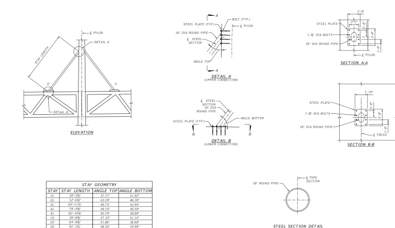

The design was forced to changed by moving the transporter positions into the inner span thereby necessitating additional post-tensions in #2 and #11. It was during the re-adjustment of these tensions that the bridge fell.
Had the bridge survived the readjustment and the first common section of the pylon cast linking the two spans together the weakness of #11/12 connection would be removed as the horizontal forces of the long span would have a reaction to bear against with. The bridge would be safe as original intended.
The bottom illustration is clearly different to the others and does look like a cable stayed bridge.
However, not sure it adds much here?
Also that illustration wouldn't work because there are no balancing cables to support the heavier span. you can only have an asymmetric design when the shorter side also contains anchor cables back to ground or to an anchor somewhere.

I thought we are clear that this is not a cable stayed bridge.
The cable is a 16" steel pipe with rather weak connection obviously not intended as a major load carrier.
Some call it a faked cable stayed bridge and NTSB has described its purpose "cosmetic".
It is obvious to me that the bridge has to be designed self sufficient without the pipe stays. Any strong member installed in the stayed section can upset the intended forces in the truss system and that can be dangerous. To me if the bridge were overloaded the bolts on the end of the stayed pipe will have to come out as a warning.
The piper stays are not as stupid as many of us think. This is because a long span bridge can be flexible and if it has a natural frequency below 5Hz it can have dynamic problem in service by the pedestrian traffic. The 10 pipe stays anchored to the two spans can act as soft springs to raise the natural frequency.
If we put a spring support in the middle of a beam we increase it vertical stiffness, right? so the natural frequency will be increased if we take the square root of a bigger stiffness (with added springs).
As for only 4 of the 6 tendons being placed in the upper canopy, I would venture that the 2 unused positions were for the addition of continuity post-tensioning after both spans were installed and made continuous with concrete. There would then be a tendency for this two-span continuous structure to have tension in the upper canopy over the central pier. The 2 additional tendons would add compression, preventing cracking, and resist negative moments over the pier creating a stronger structure for resisting live loads and other service loads.
