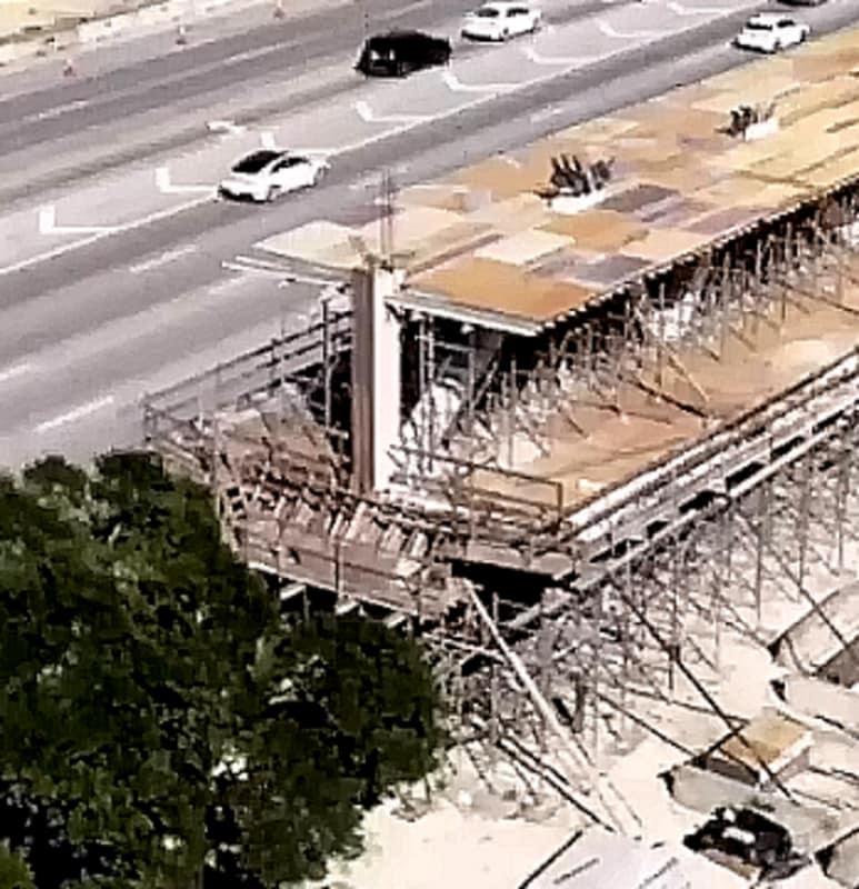

Good new posts. I doubt this was just a column failure of member 11. Like The Mad Spaniard, I question the lack of directness in the connection of struts and ties. The load path of the strut forces into the deck tie tendons is very tenuous. As with many structures, the key is in the connections.
Two things that trouble me about what I see within the design drawings posted last week (sheets B-39, 40):
1) Shear reinforcement called out for ALL diagonal truss members (members 2-11) was identical, # 4 @ 12", almost as if this was detailed as an afterthought. As you move from center of bridge span towards pier supports I would expect to see either the spacing of stirrups to decrease, or else bar size should increase (or both).
2) No longitudinal reinforcement was placed at the corner bends of the shear reinforcement in the truss members. In some instances PT ducts occupy this space, but in others nothing is there.

The short fillet block between #11, & #12, = 10" tall x 24" = 240sq inch cross sectional area.
#11 diagonal = 21 x 24 = 504 sq inch cross sectional area.
#11 is in the range of 4,000psi
The fillet potentially = 8,000 psi load. The fillet was undersized by a factor of 1/2 x #11.
#11 to deck is a somewhat flexible "construction" joint by design. The resistance to movement is by rebar attached to 2 separate pours, even worse than what a cold joint would be. #12 to deck is more like a mortise & tenon joint, because of the deck pour boxed out area, & following column pour into boxed out area. The net result is #12 is a solid connection to deck, & #11 is not.
I see this as a situation where the short spacer fillet was between a rock, & a hard place. Since concrete failure only needs .003/inch compression for failure, the amount #11 would need to slide across deck is only 8" x .003" = .024", Or for a visual, the equivalent of 7 sheets of 20# printer paper. Result, .025 travel = 8,000 psi to fillet = explosion.
If you want to adjust the block to a horizontal vector value, you are wrong. That doesn't happen until #11 force is transferred to the deck. It would also be wrong to use #11 to deck friction as a reduction in design factor on this.
A few tidbits of time line...
The tendon broke 1/2 way through the failure cycle...
When the Fillet exploded, the bottom #11 tendon started to zipper out. This proves the bottom tendon was initially intact.
When the canopy karate chopped the upper 1/3 of #11, it resulted in a humongous increase in tension (think 2 ft tall beam chopped from the top. The tendon then snapped, & jettisoned the jack past worker. (God Bless Navarro Brown & family, & may he rest in peace) It is in the videos if you look closely. It's definitely there, at the right time, & traveling out of the blister.

TheGreenLama,
I doubt that the designer considered the ties to be shear reinforcement, but rather just column ties. It appears that axial forces only were considered, not frame action. I think that assumption, along with the lack of discrete chords, meant the structure was doomed by its concept.
I think it is fair to assume the strength development of the concrete in the truss, column & diaphragm were past the minimum 28 day strength of 8500psi when the bridge was positioned on the SPMTs. The deck & truss were poured prior to the shoring & form work for the canopy. The only concrete that might have been less than 28 days could be the canopy & the blisters but not by very much. 8500psi is also a FDOT Bridge Spec. Type VI concrete. It would be a mix a ready-mix plants would have dialed in.
Something to keep in mind regarding cracking in high strength concrete, is that the cement paste & in this case silica fume bond to the aggregate is greater than the fracture strength of the aggregate itself. There is much less roughness to the plane/prism of the crack than with 3000 to 6000psi concrete. Indeed the photographic evidence of the failed concrete from the FIU bridge suggests aggregate fracture rather than cement to aggregate bond failure.
I suggest consideration of an anchor failure at the base of member 11. Anchors are shown to be 8 x 12 which is ok, but no thickness shown. Left to pt supplier. Any thoughts?
