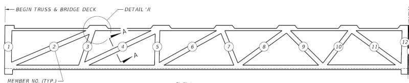

saikee said:
I don't know about others but I would say the bridge failed because No.11 lost its restraint at the bottom
Member #11 was buckling as soon as collapse began, and fell straight downwards. If #11 slipped off I'd expect it would keep going?

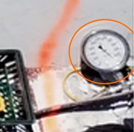

In light of Epoxybot's image of the overranged pressure gage
i'll speculate "Mystery Projectile" is a spray of hydraulic fluid.
A really strong tug on the tensioner rod from its other end would pressurize the fluid in the jack, P = F/A after all.
I believe the lower #11 tendon was anchored in #12's bottom.
As #12's bottom pivoted out to North it'd initially yank mighty hard on that tensioner.
Resulting hydraulic pressure may have blown a hose ftting or lifted a relief valve spraying oil.
A snip from bimr's picture at 16:04 above
Speculation of course.... i'd initially feared the worst (blood) but this seems more logical in light of that clearer video and the overranged gage...

I can't imagine a loading condition for this bridge that would have required the asymmetry of the trussing. Doesn't make sense to me. Anyone have an explanation?
Ron - to match the angles of the fake cable stays and semi-symmetry with the other half that wasn't in place yet.

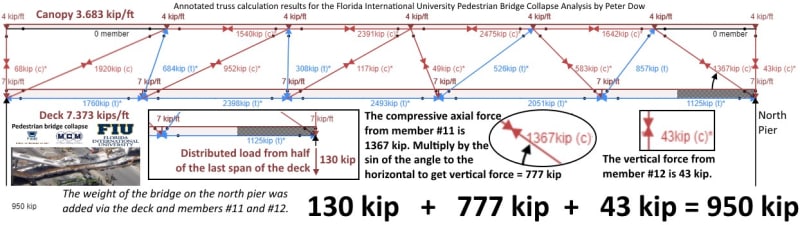

With the help of the same online truss calculator, I modelled the truss of the pedestrian bridge and calculated how 50% of the weight of the bridge (about 950 kips) would be added to the bottom end joint of the truss and onto the north pier by
[ul]
[li]the end span of the deck (130 kips - 6.8%),[/li]
[li]truss member #11 (777 kips - 40.9%) and[/li]
[li]truss member #12 (43 kips - 2.3%).[/li]
[/ul]
South ---------------------------------------------------------------------------------------------------------------North
Full-size image file uploaded to ENGINEERING.COM.[/url]
Model parameters
I assumed that the canopy and truss members were 1/3 of the weight of the bridge and the deck represented 2/3 of the weight.
I modelled the canopy and truss members as a distributed load of 3.683 kips/foot.
I modelled the deck as a distributed load of 7.373 kips/foot.
Results
The end span of the deck adds half of the span's weight to the end joint - 130 kips, 6.8% of the weight of the bridge.
Member #11 adds 777 kips, 40.9% of the weight of the bridge, which equals an axial compression force of 1367 kips multiplied by the sine of the angle of member #11 to the horizontal.
The end column, member #12 adds 43 kips, 2.3% of the weight of the bridge, which equals half the weight of the end span of the canopy and the weight of member #12.
Conclusion
The axial compressive force of member #11 at only 1367 kips is notably less than had been calculated earlier when approximating that the deck only provided a tension force to the end joint and neglecting the real effect of the weight of the end spans of the canopy, the deck and member #12.

5) gwideman's loop makes some things apparent. Like the 11-12-canopy triangle holding together. On frame 6, (to me) it appears the 11-12 connection which has moved north (sheared together, covered with black banner) grays up and gets blurry like it's beginning to 'explode' - this point moves off screen after this happens (some videos don't even show it).
I suspect the 11-12 joint 'exploded' when it was over the pier - as the canopy came down and "chopped" a few feet off the top of #11 because the canopy broke at the north edge of blister (seen in video). It would take a tremendous amount of energy to pulverize that much rebarred concrete and that joint compressing (like squeezing a wishbone) might do it.

I have been wondering about the picture of the pressure gauge.
The needle on many gauges is a press fit on the shaft. I have seen some pointers moved by pressure pulsations or by a sudden application or release of pressure.
Rather than jump on this picture as evidence of over pressure, I am more comfortable with the theory that the needle has shifted due to abrupt pressure changes during the collapse.
The background to the photo and the red line apparently spray painted past the gauge may support this theory that the picture was taken post collapse.
Comments?

Chris - anything is possible. I do note that the tensions on both #2 and #11 would need adjustment after the move, but only #11 is associated with further concerns, so if they had filled the openings after the post-move adjustment, why would they also open #2, which was intended to be tensioned in the original plan versus #11 which was not to have any tensioning at all.
This makes the jack hammer a puzzle, but the photo is after the start of rescue and recovery efforts, so I don't know if it was in use on the top of the bridge.
