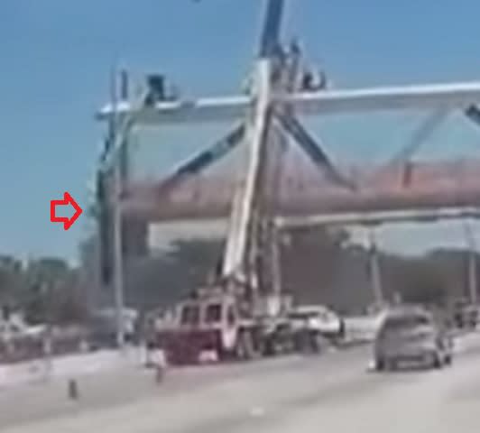

dilbert said:
Go to the original twitter feed for the video. It is much clearer.
Wow - that one sure makes the mysterious 'bulge' or 'puff' look more like a definite breakout.
That link Dilbert gave points to DailyMail , which appears to be a copy of a youtube by one 'officialjoelf'

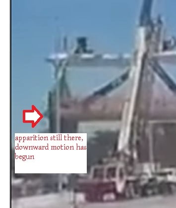

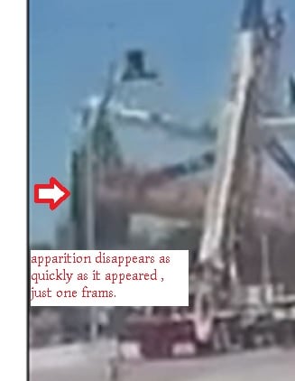

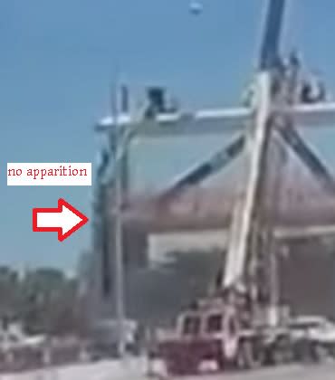

Here's the youtube "officialjoelf" version which is clearer yet. I wonder were he got it...
and you can play it back at 1/4 speed with the youtube controls. I will try to figure out how to single frame it , for now here's four images you ought to see. About seven seconds in...
( i hope this youtube isn't some kind of hoax)
just before start of collapse
Next frame, as close as i can control playback. The apparition appears immediately, not as if it were camera angle.
A few frames later
The apparition gets pulled back in
Thanks @ dilbert for finding the clearer video.
Looks to me like something got slammed out behind and hit a definite limit to its travel, then was yanked back in during the fall.
What do you guys think ?
EDIT --- AHA ! Youtube single frame control: pause, then press period ( . ) for ahead one, press comma( , ) for back one.

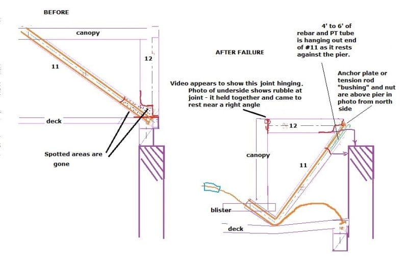

saikee119: thanks for the drawing. From other photos, the 11-12 connection area is "busy" with large horizontal PVC pipe underneath, several 3"(?) vertical PVC pipes next to 12 on both sides, and tension cable ducts near the surface. It was a weak area, but still held the lower PT rod anchor plate as it ripped away from member 11.
I no longer think a large chunk broke from the deck, but that 11-12 sheared as gwideman shows in IV-23-17:09. Appster has construction photos (IV-23 Mar-22:21) - it appears the deck was poured first (photo 6,7), then members second (photo 8), though can't tell how end/diaphram was done, or where PT rod anchors were set (FIU print only shows top). I think the shear/break point was the deck instead of going into diaphram - there's a 'box extension' on 'back' of #12 (where PVC pipe comes out) with what appears to be a "pour line" - this is where 12 broke/sheared, but the ends of 11 (4' to 6'?) and 12 (2' to 4'?) completely disintegrated.
Below is a (very) rough drawing of how I think things ended up (I can only do 90o rotation - using sailee119's for outline).
Bottom of 11 and 12 were shattered (red dots) - while rebar from bottom of 11 was still fairly straight (I don't understand how this could happen). It doesn't seem rotation of the north end, with ends of members sliding across/landing on top of pier, would have enough force to shatter that much rebarred concrete.
(Note: I thought this end was similar to the south end 2-3 PT rods, but print shows top of upper rod a dead end anchor (adjusts from below) and lower rod adjustable from top. Anchor plate spec is 8"x12" but 11's upper tube plate in photo resting on top of pier looks smaller (like those I see on PT rod sites for the nut end). Both rods on 11 were adjusted from top, and they appear to have a LOT of threads showing (I don't if this is normal). I tried to find a good photo of 2-3 since it had been adjusted earlier, but couldn't find any with good detail (2-3 blister photos show the top opened up/chisled(?) larger, similar to 10-11)

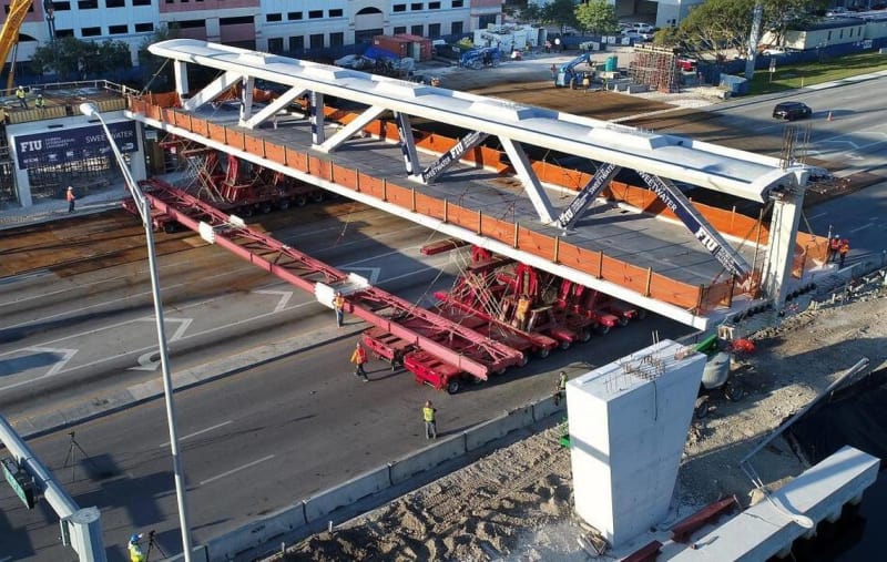

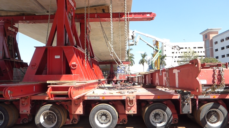

The underside of the deck is taper when it was on the four transporters. In the final position the support is the flat bottom of the downstand beam (or end beam). Alignment should not be a problem for a simply supported condition. I expect the bearing pads to have some compressibility to take out any small unevenness.
4 Transporters tied together by 2 huge girders supporting the bridge with timber wedges
I do agree with your sentiment that the structure could have suffered some damage in the move. On the transporters it was confined by large timber wedges. Although the transporters were bolted together by two huge girders to form a rigid table but the jacks were not and definitely have some flexibility. Since one end acts as a pivot while the other traveled 1/4 of a circle, any flexibility in the jack supports will cause the 4 supports not moving simultaneously and the bridge will be bent laterally.
I agree the bridge in your link did rock from 0.44 to 0.50. While this does not necessarily translate into damage but it clearly shows the cantilever did experience some disturbing forces. My approach would be include some dynamic load as a load case in the analysis of the maneuver.
When cracks were reported and confirmed not affecting safety at the north side, same side when it rocked, my initial thought was the bridge might have suffered some damages from the dynamic condition.
