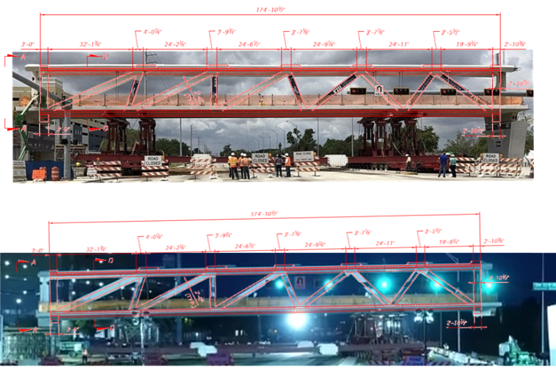

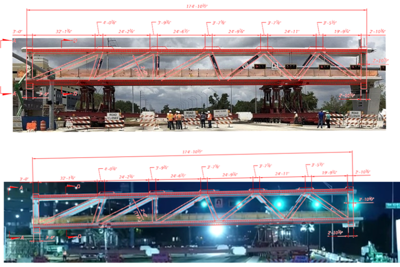

This is only partially useful, but some may find it interesting. I took the elevation drawing from MCM FIGG Proposal of 2015-09-30, and mapped black to red, white to transparent, and used it here as an overlay on two of the most straight-on photos of the bridge I could find.
Here is the effect of fitting the drawing to the end verticals (#1 and #12):
And here is the effect of fitting the drawing as closely as possible to members 2 to 11.
In each case I scaled the drawing uniformly with 1:1 aspect ratio.
This exercise is not perfect by any means.
1. Obviously perspective. I have scaled the overlay uniformly and positioned it to match the end verticals (#1 and #12) or the other members (2 to 11), so this is an attempt to get the elevation drawing to match the centerline elevation slice of the bridge.
2. We don't know if the 175 ft length is before or after the additional lane was added. Others in the thread reported that both ends of the bridge moved north by 11 ft, others think that the bridge got longer, but we don't know if 175ft is before or after this. If the bridge is actually 186ft (say), and I matched the 175ft drawing to it, that's only about a 6% mismatch, and might not be noticed in mismatch of the deck and canopy, for example.
I have attached a transparent gif of the elevation overlay in case it's useful to anyone.

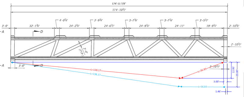

I was curious about the basic geometry, and how far would the lowest point of the deck have to fall in order for the north end to clear the edge of the pier.
Not all variables are known for this, for example exact length of bridge (I used 175 ft), and amount by which the north end of the bridge overlaps the pier (I used 3 ft).
So if there's a single fold, and it's at the base of #10 and #9, then when that point descends about 13ft, the north end of the deck is clear of the pier. Of course, it might clear earlier, if the folds are more complicated. And there's some chance the deck might initially stretch a little, or pull the pier inward.
I've also noted that when the deck is on the ground, if it stayed in two contiguous pieces it would impinge on the pier. As it turns out, the north end of the deck rests just short of the base of the pier, consistent with the deck shortening a bit corresponding to multiple folds at several locations.

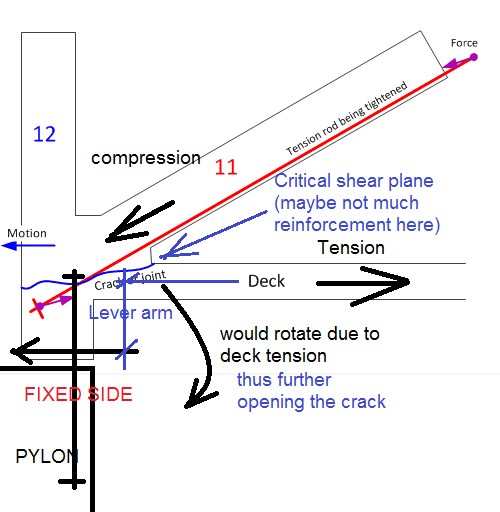

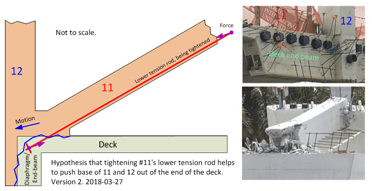

Let's go back to the bottom PT rod here.
Two massive assumptions here:
1) the crack that was being talked about was at the base of the no 11 member with the deck or somewhere close to it
2) to "pull" the crack back in line they decided that the thing to do was tension up the PT rods bars as the anchor point was beyond the crack and it would then close up or arrest the crack growth.
However in doing so they actually then increased the compressive stress and force on the bottom of member 11 which found its weak spot and just went bang?? Maybe if the bottom PT rod was not straight, but bent over to anchor into the slab it actually started to pull out of member 11?
It wouldn't have taken much movement of member 11 (a few inches?) before it effectively lost all compressive force and as far as the structure was concerned then became redundant, leading to failure of the remaining parts of the structure.
I do always wonder when things are built in stages / separately, whether enough design and analysis is undertaken on those stages and not just on the final item. It's fairly clear that the second span would butt up to the first span on the other side of the pier and then combine to make the tower structure. This would then help spread the load and prevent a blow out type event.
As an aside, every time I look at that bridge from the recent dashcam footage or the one where someone wanders around the bottom deck just after it went up, those members just look puny.

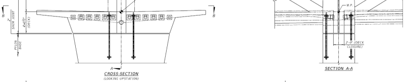

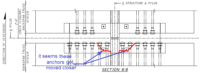

jrs87, those are shims, not teflon as shown on the proposal drawing below, unless there was a change on the final drawing.
The slide side is on the south side, the south side View C-C were mistakenly posted numerous times in part IV.
Post Edit Addition, likely the anchors had been tightened in place, this could explain the skid marks on the pylon, and "base of 12 missing?" posted by INCENTIVE in Part IV 25 Mar 18 04:53, and Part V 27 Mar 18 00:45:

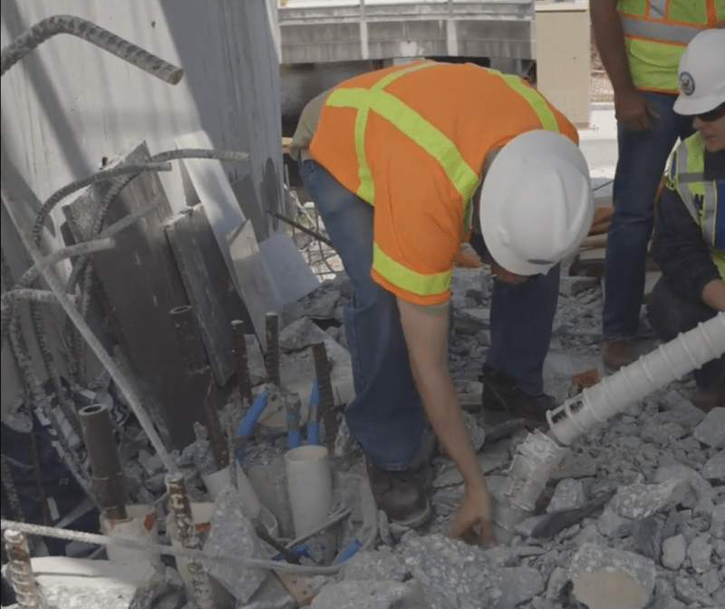

I re-post some 23 Mar 18 10:54 photos from gwideman and wish to point out some anomalies to construction/structural people.
These two photos confirm (1) there is a construction joint at the interface of the walkway deck with No.12-11. (2) There are 4 vertical plastic sleeves or pipes, look like about 3" diameter to me, cast with the deck. Two on either side of No.12. There are some reinforcing steel bars, possibly for anchorages for other installation, and blue flexible small ducts or conduits, which I think could be tubes for grouting and de-airing the PT ducts in No.11.
There is nothing odd about the above items. However a construction joint if not properly prepared is a plane of weakness and can never be as strong as a monolithic construction without such joint.
The photo below is the best I could blow up to show the anomalies in details. It has been posted several time before.
I find the photo odd because
(a) The No. 12 has gone but the 4 white plastic pipes are there. The tilted one appears to have suffered some damage. If No. 12 was pushed out shouldn't it take out the 4 plastic pipes too? Concrete is much harden than plastic. So such condition would suggest bottom of No.12 was disintegrating when it left its position on the deck so that the small broken concrete pieces could not drag the plastic pipes away.
(b) The No. 11 has gone too. That is expected but shouldn't we find some reinforcement that connect No.11 with the deck here. I can see one or two small size bars around the foot of the investigator who was looking at the anchorage of the bottom PT rod of No.11.
(c) The first two drawings clearly show the 4 plastic pipes cast outside No.12 but the hole shows the 4 pipes are inside it. Has part of the deck also disintegrated too to leave behind the plastic pipes intact?
(d) Between the far end vertical and tilted plastic pipe, near the investigator's foot, the surface of the hole looks remarkably clean and straight as though it was formed by formwork and not ripped out from a homogeneous concrete mass. The only possible explanation to have such good surface "finish" is this area has been boxed out when the deck was poured. There afterward the 4 plastic pipes were installed and the void was filled with second stage concrete. Nothing wrong with this construction as it happens all the time on site. However it would be suicidal to do it at a joint that has to provide restraint to arrest a huge horizontal force from No.11.
(e) The only reinforcement of the deck in this photo is at one location a couple of small bars located between the undamaged vertical pipe and investigator's foot. The amount and size don't look like proper deck reinforcement to me. SO if this area has been boxed out did the workmen trimmed the reinforcement around it too?
To assist understanding I provide my own interpretation of other items in this photos.
The steel plates and other plates stacked against the abutment could be the remains of the bearings. The plastic pipes could be for the holding down bolts which in the proposed drawing only two were indicated and they are a lot far away from the No. 12. Other photos show no holes for the hold down bolts. gwideman other photos has depicted what looks like two holding down bolts on the abutment but the plastic pipes can also be conduits for other services. The back of the No.12-11 area has some 5 reasonable steel bars and a few smaller bar bent against the abutment wall. They could be the rebar linking No. 12 or 11 with the deck.
I have been haunted by the above last photo ever I saw it. Many of us talk about horizontal shear in No.11. A shear could only happen if one part moves while the other part remains stationary. Looking at the above photo and what have left in No. 11 and 12 make me think may be the supposed stationary part of the deck had moved out first to trigger the collapse. It is not really that far fetched if there is hardy any reinforcement provided to "restrain" the No.12-12 from moving outward. The concrete alone is unlikely to stop the two vertical triangular faces beneath the deck to shear off vertically. The back of No.11 could out by tension. Any reinforced concrete designer knows concrete has very resistance (in similar order as the shear resistance). The nearly untouched condition of the 4 plastic pipes does not inspire confidence the construction quality at this location. Furthermore if Tony Pipitone report were to believed during failure the tension adjustment has to increase tension, since the tension was released in the first round, then the crew was pressing their luck by pushing the No.11 out of position by increasing its axial compression.

Updated image for the hypothesis that tightening member 11's lower PT rod could have helped to push the base of 11 and 12 out of the end of the deck.
Since a few people have reposted the earlier version of this diagram (gwideman 23 Mar 18 17:09 in Part IV), I thought I would update it to add a couple more details, and bring it in line with more recent observations people have made about various collapse photos.
