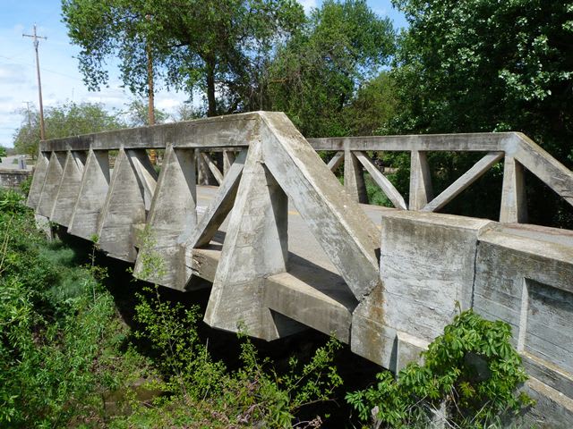

Here is a concrete truss type that indicates designer was concerned about tying members to deck.
jrs_87,
In that picture, tying to the deck is important, but that's not what's driving the increase in section as the post approaches the deck. Underneath the deck, at the posts, you can see a beam underneath. This is a "half-through pony truss", otherwise known as a "handrail truss" in my neck of the woods. While the posts and diagonals obviously brace the top chord at the panel points for buckling in the vertical direction, the posts rely on a moment connection with the beams under the deck to provide the out of plane bracing for the top chord (if SlideRule is still reading this thread, I imagine that he will see the obvious need to use Engesser's solution). So, any aggressive tying in to the deck is really a by-product of the posts tying in to the beams underneath.
Really, the deck is spanning between the beams underneath. There's really not going to be the crazy force transfer between the posts/diagonals and the deck as there was in Miami.
At any rate, that is a really cool looking bridge. Were you able to find a location for it?
