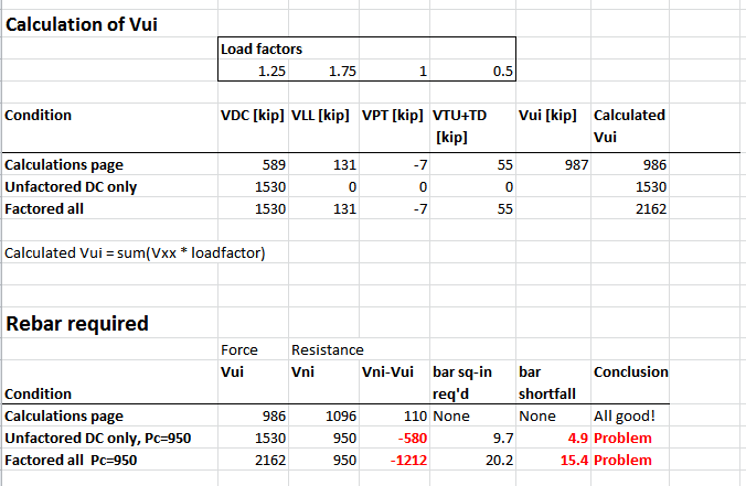

The following image shows several versions of the calculation of the shear force (Vui), and the implications when compared to Vni (shear resistance), and resulting rebar requirement.
Of note:
1. So far as I can tell, the bridge should have been designed according to the "factored all" row, in which case the provided 4.8 sq-in of rebar is 15.4 sq-in short of the requirement.
2. But as a better idea of whether the bridge should be able to stand up at all, we might neglect the live load, and the load factor, and just use raw VDC as the horizontal shear. That would result in a requirement for 9.7 sq-in of rebar, double what was provided. (The calculations page conservatively omits any reliance on concrete cohesion, so presumably there some additional shear resistance from that source not counted here.)
Summary:
[ul]
[li] The horizontal shear force VDC was stated as 589, clearly less than the 950 it would be for a 45 degree member (ie: no-calc reality check should fail), and hugely less than the 1531 I calculated for #11's actual angle of 32 degrees. [/li]
[li][/li]
[li] The horizontal shear resistance concrete friction component was overstated by 30% by overstating Pc. (But that error was reduced by the contribution of the "negative rebars".)[/li]
[li][/li]
[li] The rebar area was negative, which essentially means that so far as the calculations are concerned, the rebars were unnecessary for shear resistance, a clearly absurd result.[/li]
[/ul]

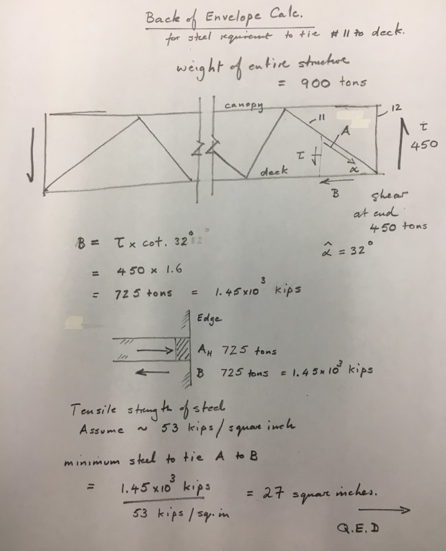

The calculation below took less than 10 minutes. The calculation is an "order of magnitude" check. It ignores live load, to provide a rapid check for absolute minimum steel required to tie diagonal 11 load to the deck load.
The calculation confirms the calculation above almost exactly. One could add factors and the like, but the correct answer is somewhere close to 28 square inches of steel needed to tie the compressive forces in diagonal 11 to the tensile forces running in the deck. NOT the 5 square inches actually provided.
FortyYearsExperience said:
... 23.4 sq-in...
Thanks for commenting. As it happens I was in the process of tidying the spreadsheet I used, and discovered that I had applied the load factor for VDC twice. I have corrected that error in the post you commented on.
The general conclusion is the same. Just that the 23.4 sq-in should be "only" 15.4 sq-in.
And I think your sketch assumes that shear resistance is provided only by the steel, at 53 kips/sq-in, whereas the calculations page (and my calcs) get 950 kips of resistance from concrete friction under load of 950 kips, and use 60 kips/sq-in for the steel.
For what it's worth, 950 kips would be equivalent to 16 sq-in of steel. So that puts us both in the same ballpark.
Thanks for your interesting and thoughtful observations.
I believe however that the shear force between the tie and the deck is 1,450 kips, not 950 kips. (= one half weight of bridge, times cotan 32 degrees).
Also, I am puzzled that you find a reduction in shear can permissibly be attributed to concrete friction. The way I understand the shear capacity of reinforced concrete is to ignore the concrete when analyzing the steel. Then, do a separate check to see if the concrete can withstand the compression. In this case, I believe it cannot withstand the compression, but my check ends with the steel because it is hugely inadequate.
Appreciate any further thoughts.
First, I think the 950 kips you're looking at is for Vni (resistance) not for shear force.
So the figure for plain horizontal force that I used was 1531 (not 1450), as follows:
I actually did it in two steps: 950 kips vertical --> 1802 kips diagonal --> 1531 kips horizontal. (This way I could match the diagonal force with a slide in the FIGGs "crack meeting" presentation).
However, to go directly:
Angle = 31.82 deg
Cotan(31.82 degrees) = 1.6115
Vertical force = 950
950 x 1.6115 = 1531 horizontal shear force.

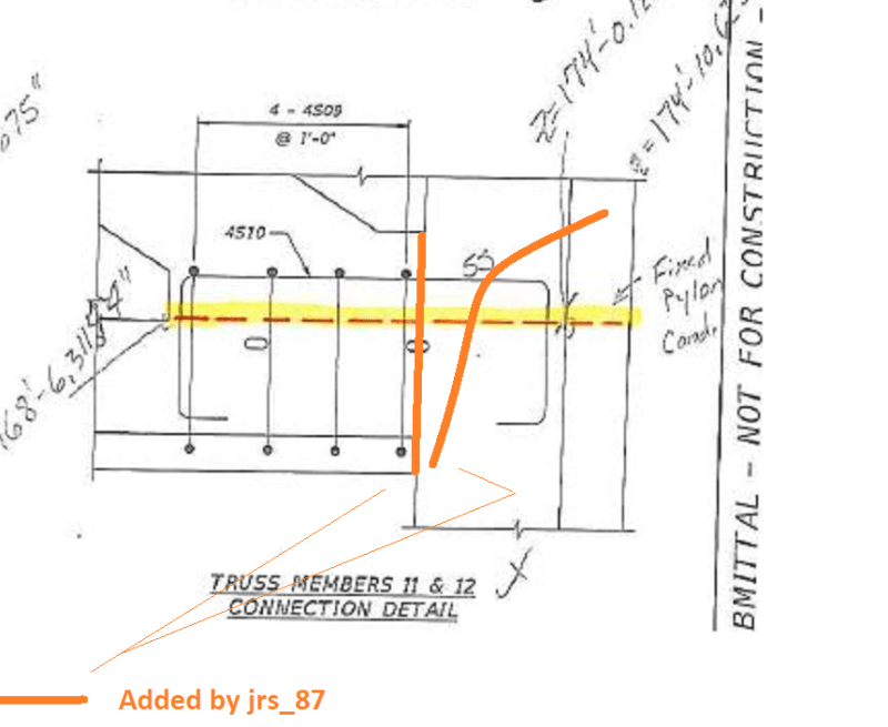

Though it is curious that the cracks meeting presented an examination (meeting PDF slides page 27 and following) of a different shear interface, rather than using the ones for which calculations were already available. (And as I've discussed earlier, the slides appear to overstate the shear interface areas, the perpendicular ("clamping") force and the rebars crossing the interface.)
I would even question the use of the 4 - #7 stirrups as contributing to the area of shear steel, the way they are detailed. The requirement states that the steel should cross the expected shear plane perpendicularly, AND that the steel be fully developed on either side of that plane. It's not clear from the design drawings how far the stirrups extend above the top of deck. Simply extending them above the deck construction joint (1" or 2" or 3") is not enough. To be fully developed (90-deg. bend) they'd need to extend at least 11" above the deck. And, if you wanted to use the steel coming from the diagonal for this purpose (that's assuming those J-bars are placed properly and fully developed), because they're crossing the shear plane at an angle, I would reduce the effective area based on the angle of the incoming diagonal--say use only 32/90 of those bars.
Is it clear where FIGG is pulling the numbers from for doing these calcs? I've looked through parts of the calcs only briefly. Page after page of tabular data cause my eyes to glaze over. Any thoughts on why 2 computer models were done. I haven't looked at the FEA at all, except to note that it's undated, done by someone else (not the LARSA modeler), and models only stage 1 of construction.
I entirely agree. There is, in reality, zero amount of steel provided to tie diagonal 11 to the deck.

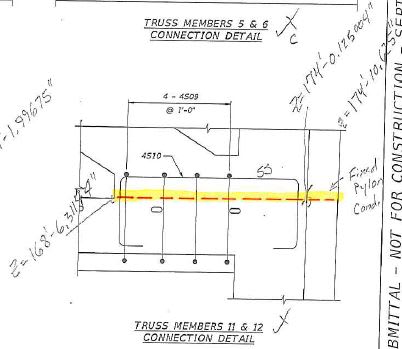

Has anyone here seen any evidence the emergency center-line shims were actuality installed and when? Is it possible the shim jack was being operated in conjunction with the PT rod operation? Obviously the diagram would have to be lifted some order of magnitude to fit the shim effectively.
Bear with me for a moment... I have faith in Figg in so far as engineering goes. I argue they think just like us and it rarely is useful to underestimate people. When they decide it's necessary to shim center-line, implement an "exoskeleton" to add confinement to 11/12 node, and get CIP tied in ASAP, I believe them on that. These recommendations suggest they knew what was wrong even if candor may have been lacking to some extent.

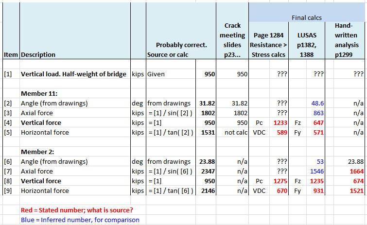

At this point I'm fairly satisfied that, as described in my earlier post, UCPP_Final_Calculations_Superstructure (1).pdf PDF Page 1284 (labeled 1283) is where the stress resistance is supposedly checked against the stress demand, and wrongly passed due to wrong input numbers.
So I agree with:
... that one point of interest now is where did those numbers come from?
In summary, the numbers that I think are of most interest are the red ones in the following table:
Here I show what I think are the correct values for key variables, and the four calculations that we've seen presented. (I've included the calculations pertaining to member #2, because it allows comparison to the handwritten notes page.)
Clearly the biggest puzzle is how the half-weight of the bridge was not the number used in the key calculations. The angles of the members were also wrong with a comparably harmful effect on the calculations.
A related issue is how the rebar area on page 1284 came out negative, which is impossible. That didn't help the bridge to pass muster, but it does imply incorrect formulas behind the result table, and thus a flawed process in setting up this critical design-check report and also the checking of it, both of which would make illuminating lessons.

And, Gwideman, I agree that when looking at this puzzle it's good to incorporate Member 2 in the summaries, for comparison purposes.
TheGreenLama said:
p1298 of calcs... Shear Plane 1... Presume loads are taken from 2D LARSA.
(aka PDF page 1299)
I agree that the free body diagram is satisfyingly visualizable. But it uses a vertical load of only 674 kips (and correspondingly low axial force).
TheGreenLama said:
p1381 of calcs ... Could it be that Shear Plane 1 was checked using only the load over this area, excluding the Member 12 area? Could it be that Shear Plane 1 was checked for fixed pylon case?
(aka PDF page 1382)
I wondered those points too. But the vertical load on #12, while substantial, would surely be only a small fraction of the 950 kips half-weight of bridge.
And somewhat countering the pylon speculation is that the interface length chosen is only 5'-5.8", which includes the entire dashed red line, excluding the fixed pylon.
I did search the entire calculations PDF for the key numbers I've highlighted previously in red, and found none of them. (And when looking for "647" for example, I searched for "647", and also "646.", on the basis that the page 1382 calc might round up.)
Member 11 is offset from diaphragm support. Would areas I marked in orange also be subject to shear? Does anyone know where the steel for this is detailed? And would not the PT bars have messed with this?
